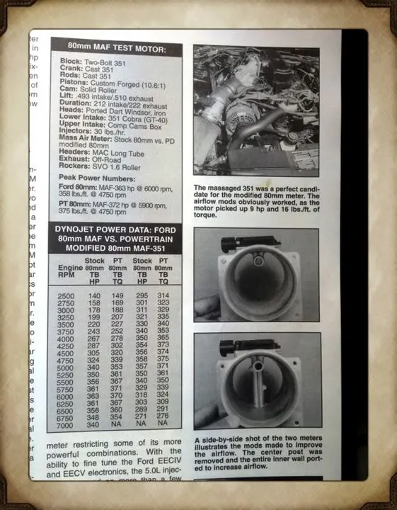

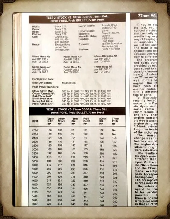

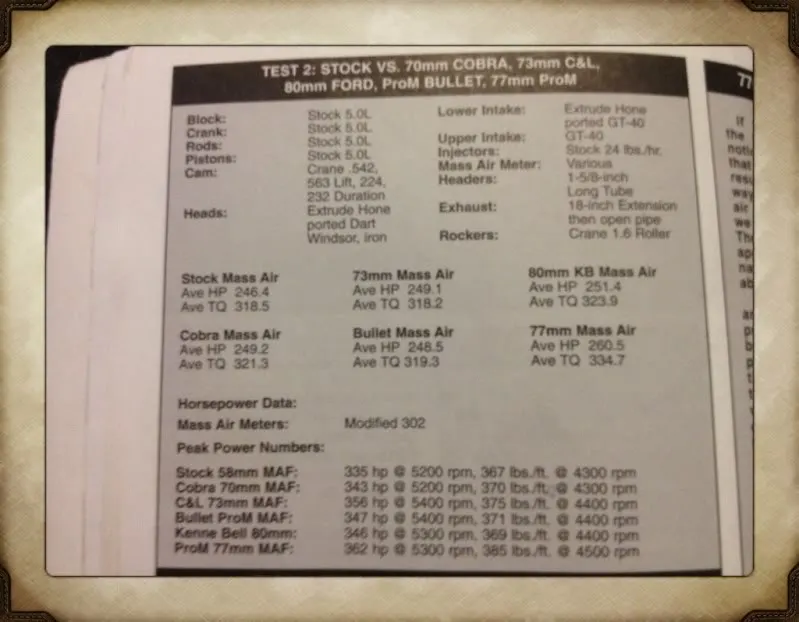

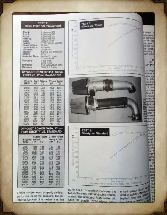

I had AFR 185's, Holley, 70MM TB, Pro-M 80MM which outflows the 75MM by a ton and huge 1-3/4" Long Tubes w/ 3" Collector and 3" Prochamber / 3" Catback. Your car would benefit greatly from all this.
The Pro-M 80MM is top dog in CFM which is why I bought it.
5. MAF AIR FLOW DATA (In CFM):
1.Stock 5.0L 58MM (89-93 Mustangs), 606 CFM
2.Stock 5.0L 70MM (94-95 GT/Cobra Mustangs), 815 CFM
3.Pro-M Bullet (75MM), 964 CFM
4.Ford 80MM (Lightnings), 1017 CFM
5.C&L 73MM, 1171 CFM
6.Modified 80MM (Flow Bar Removed), 1368 CFM
7.C&L 80MM, 1415 CFM
8.Pro-M 77MM (Shorty/Supercharged Version), 1543 CFM
9.Pro-M 77MM (Standard Version), 1562 CFM
10.Pro-M 83MM, 1598 CFM
11.Pro-M 80MM, 1612 CFM

Do you have the information on how those meters were tested? I know the monster 97mm Abaco only flows 1252 CFM at 20.4 in with a 10 inch filter.
