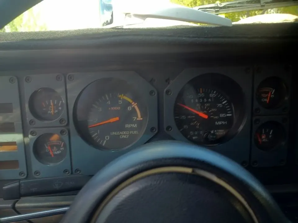

Based on what you've given....I'm gonna say 2.73's. Of course, that all depends on the accuracy of your tach and going with the assumption you're using the stock 25.6" tire diameter. Either gear should be replaced with something in the 3.55-3.73 range for spirited driving.
