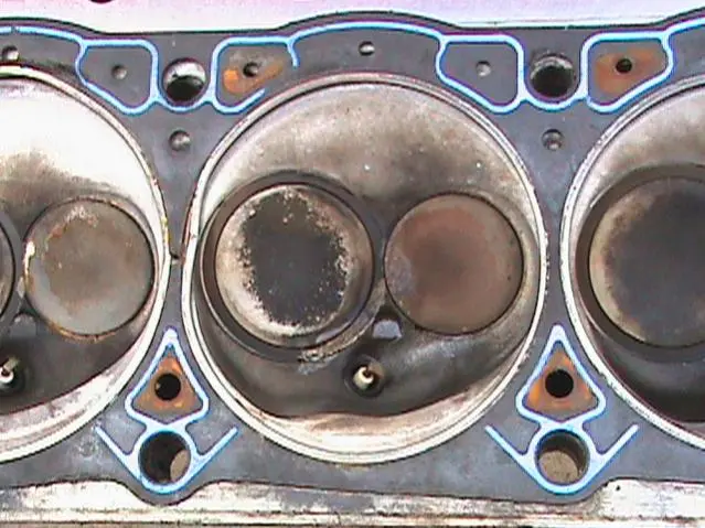

1011-1's or 9333's, 1011-2's don't seem to be that "sturdy" based on the pic below. Even though studs were also installed, I won't use 1011-2 HG's..... they were replaced with 9333's and have held up fine.
