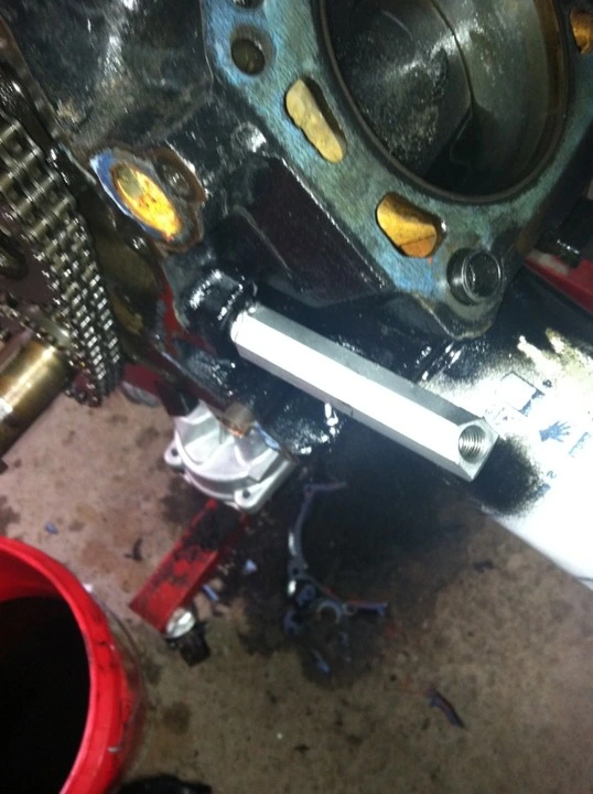

The hex rod is for the oil pressure sending unit...

The block is actually npt thread...if you try to chase the block with yours it'll cut new threads and screw the hole

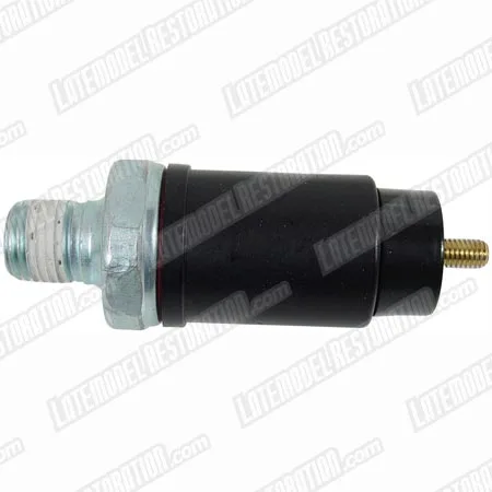

I just looked at the pic of your oil pressure sender above. It appears that the thread on the sender is not NPT (as it's not tapered), but it's known that the hole you are screwing into is tapered. This still works fine as long as the size and thread is the same.
Really, you can just screw the thing in till it's tight and you're good to go.

The problem now is any metal that is in that oil passage, you should have not run a tap through it with the motor assembled.
NPT threads are tapered, a few threads will stick out...no big deal, use sealer as suggested.

thats what it should look like
