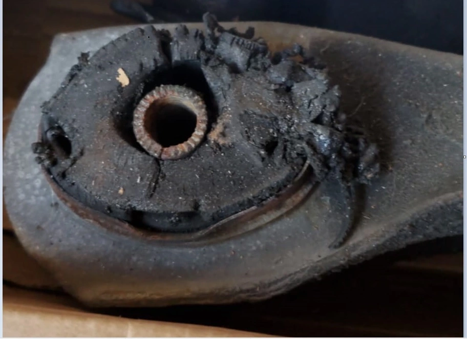

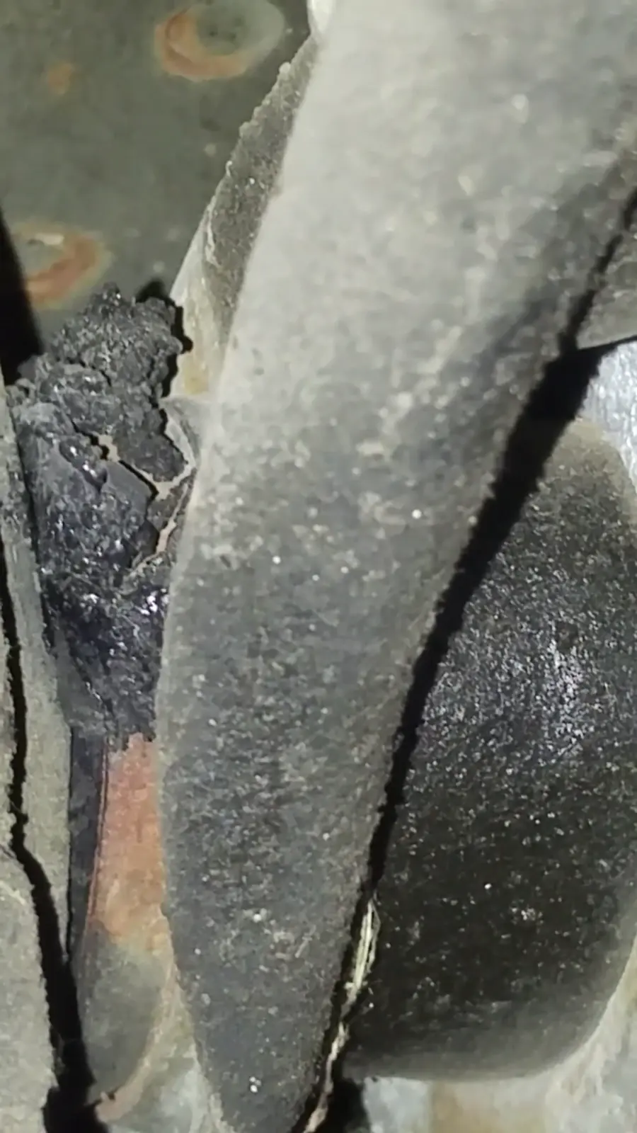

Thank you for the replies, I jacked it up and tightened the 2 bolts on each side of the rear sway bar.
While looking around, I noticed something abnormal and took a couple photos. Both sides are displaying this.
(Drivers Side Rear in the pics)
What is that?

Yup, if that is the rubber from the bushing eroding out and not just road crud, you've found the likely issue. I replaced mine with Maximum Motorsports HD LCAs...these have a urethane bushing on the chassis side and a spherical bearing at the axle...great mod. Consider replacing the uppers with new rubber bushings at the same time (I did while I was down there). Both are worthwhile corrective/performance mods.
Btw, read the info on the Maximum Motorsports website as to the "why" of retaining rubber bushings in the uppers...explains it better than I can, but in a nutshell it prevents binding of the suspension and torque box damage.

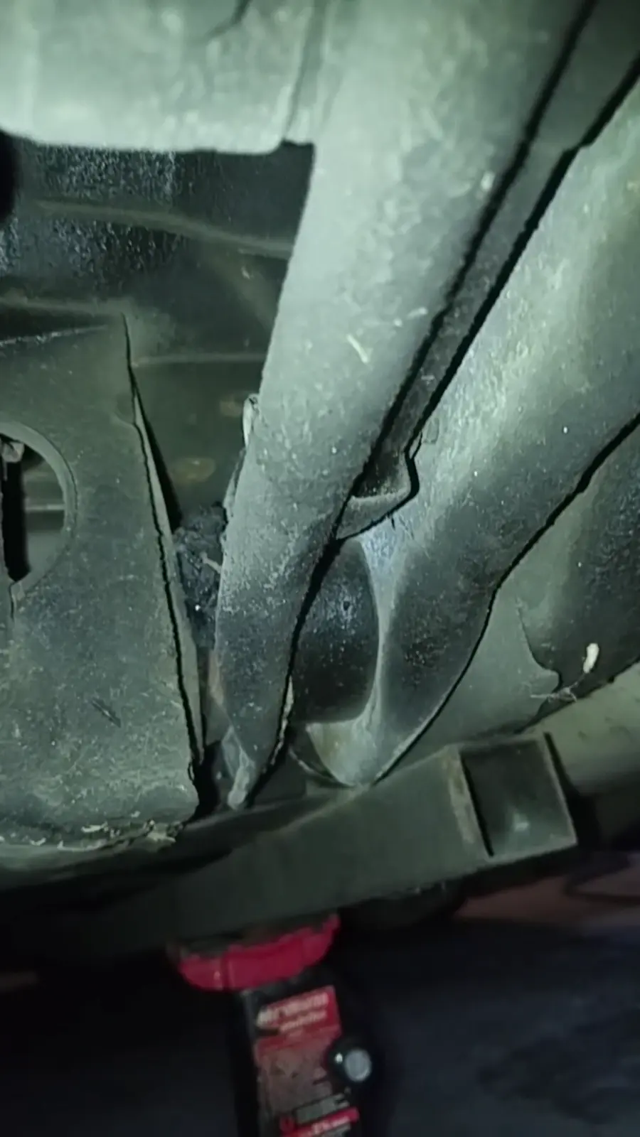

It brings a sense of accomplishment knowing it was the right decision :) Thanks for your help along the way.
Clunk is gone.
