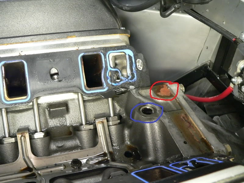

What hole is the one that is circled red?
I believe the blue circle is an oil galley plug, but I do not know what the other hole is.
It is threaded.
(This is not my actual picture, so mine is not filled with orange RTV.)
I was replacing the lower manifold gasket and noticed this hole filled with grease. No cap or plug.
The block is a 1990.
The threaded hole in the back of the block is for a knock sensor....usually found in 5.0 truck blocks but some did make it into mustangs....no need to plug the hole...it goes toward the area where the flywheel is.
