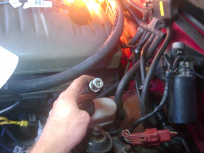

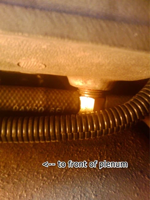

I was replacing the main wiring harness in my '91 GT (electrical fire at coil/solenoid, ughhh) and yanked on "something" to get some slack in the bundle which resulted in a slight "pop" sound followed by the pictured hose coming out. I can't for the life of me figure out where it goes. It originates from a brass 'T' on the underside of the upper intake manifold. The other side of the 'T' recirculates into a port underneath the upper. The end of the hose has a circular metal connector with a one way valve hole (?) in the middle.
Where the heck does this connect to??

Hi guys. Well, the reason I was so freaking baffled about fitment is because the PCV grommet has either disappeared or was never there in the first place! Looks like I need to find a grommet at the local parts store. Thanks again.
I'd recommend using a Motorcraft grommet and PCV valve (they fit together tight - some aftermarket stuff does not).
You can also get a grommet (from Motormite IIRC) at the parts store.
Make sure the 'breather' is in place in the lower intake. It goes below the grommet and valve.
