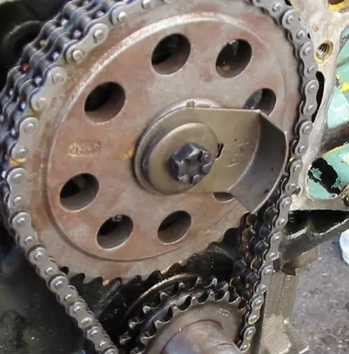

Hey All,
This is on a later model 5.0 that has an unknown history:
What is the "L" shaped thing on the cam sprocket? Is it simply an oil slinger or is it a mechanical fuel pump actuator? If not for the fuel pump, what do I need on this engine to use a mechanical fuel pump? I already have the correct timing cover that was NOT on the engine when it came to me.

Don't know what that is....but you have to have a fuel pump eccentric that bolts there, just an offcentered circle really to work the fuel pump lever . Sorry I don't have any part numbers, but you can hit summit up, they have them on there. You may also want to check with your timing chain manufacturer, I have heard that some sets require a 2 piece eccentric...not sure about that though.

Here is a link to what summit has, they have one for 7/16 bolts too, this one is for 3/8's...I think all you need is this part and your fuel pump, and your proper timing cover. (I don't think ford has a pushrod to actuate the lever like chevy does)
