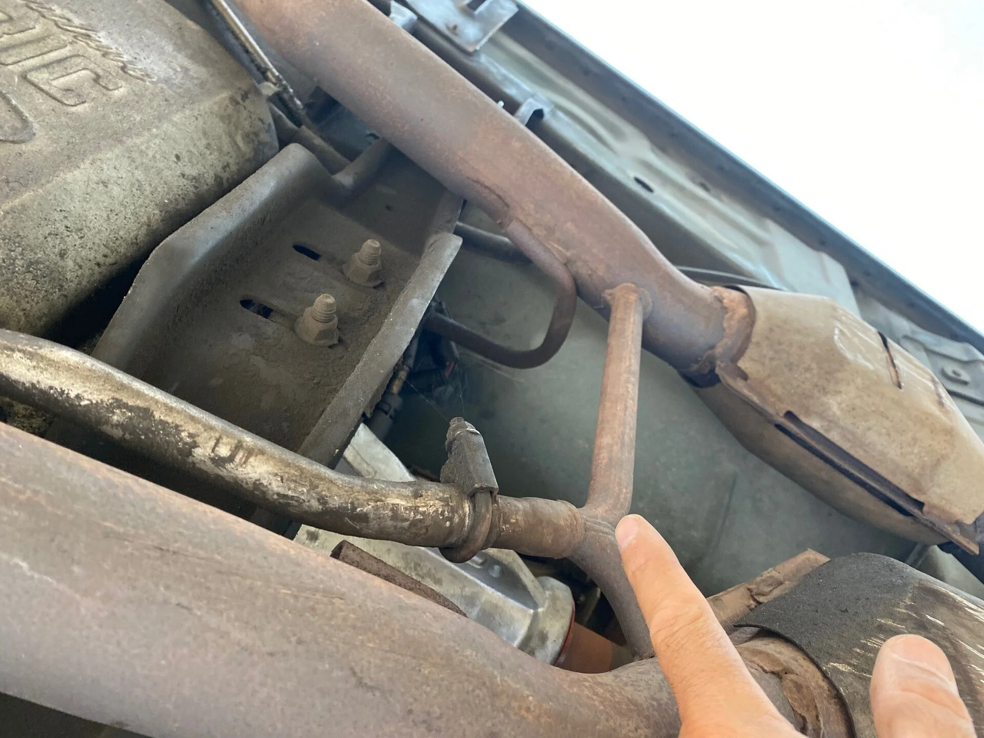

Hi All,
Looking for some assistance on what this tube is for? The car is all stock. Is this part stock?

Helps warm up the cats upon start up, don't really need it if you upgrade the cats to high flow.
Not sure about CA smog though.
I passed CT. emissions multiple times without it and a high flow catted X.

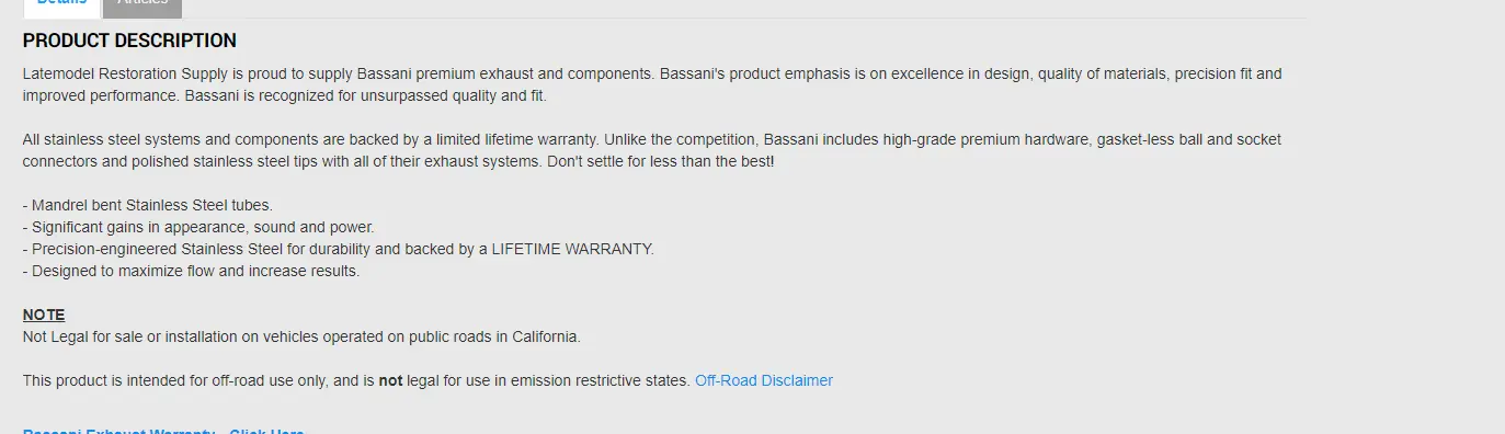

This should pass the sniffer and visual inspection. But...
“Technical Note. This BBK product is not legal for use in emission restrictive states”
I would check with BBK for sure on that.

For CA, the smog pump and plumbing needs to be left intact, even if the high flow cats installed do not technically require it. Given the price of CA-legal h-pipes these days, the OP is better off leaving the stock H-pipe and just doing a cat-back exhaust. They won't miss that extra 5HP.

I put a Bassani stainless steel X-pipe with high flow cats on my ‘86 to replace the stock H-pipe with cats. The Bassani came with the Thermactor tubing just like in your picture.
Reactions: Blueinfan
Looks like its not valid in Kalifornia
