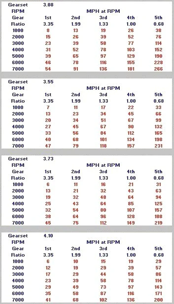

Hoping for someone with a stock rear end (which I think I have) to compare against but any will do, I may be able to calculate....my other thread says tach fixed and high rpm problems, paid close attention on the way home and now doubting myself.
I pulled 72mph @4500 in 2nd gear...
Normal? rpms seem too low? what do you pull (please include rear end gear ratio)
Thanks!!
1.94 second gear ratio, with a 3.73 rear end and a 25.7" tire, I get somewhere around 60 mph.
http://www.wallaceracing.com/Calculators.htm
There are a lot of good calculators in the link above. You can figure your tire height, then use that with your rpm and mph to figure rear gear ratio. Assuming your tach is correct and not malfunctioning, I think you would have a pretty high gear in there (2.73 maybe?).
Joe
This chart is based upon stock 225-60- 15 tire size
Reactions: Jace78
So stock tire height 25.63, mine is 25.68..so very close. My thoughts may be correct then... even if I am at 2.73 rpms seem low... I guess I am going to go with chalk method, unless does anyone know if I can tell what was installed by the VIN?
<<edit well, 65 mph at 2000 in 4th, 2.73 i guess :( >>
