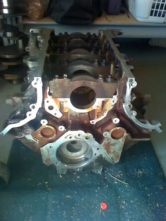

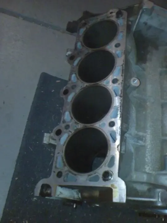

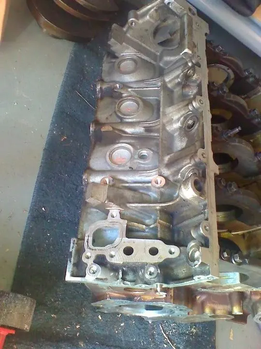

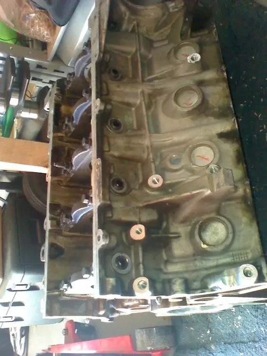

A friend of mine gave this block to me with timing chain cover, forged crankshaft, valve covers and oil pan. He said that it's a 4.6L Windsor Aluminum block. I'm going to clean it up and start a build with it. Tell me what you can about what you see here.

The best way to identify a block is by the part number. Do a google search for the part number and you can probably figure it out. It looks to me like a Teksid block. Notice it has 6 bolts per main.
As for having a forged crank? You'll have to check the part number and such too. It is very common for the teksid engine to come from the lincoln Mark VIII, which has a cast crank, but the cobra got a forged crank.

Looks a bit like the aluminum block used in the 96-01 Cobra. I think it's a Romeo. The main caps have 4-bolts instead of 2-bolts and dowels (though I'm not positive the W engine used the dowel arrangement on the aluminum block...) Also, there's no "W" I can see cast into it from the pictures you show.
Could be wrong but it looks like it uses jackscrews on the sides of the main caps which puts it earlier than 1999.
Looks like there are some numbers cast into the block on the driver's side near the 3rd main cap jackscrew. What do these read? Are there any other casting numbers elsewhere on it?

Its an early 93-98 Teksid, I have about 6 of its brothers sitting here.

Okay... part number is RF-F2LE 6015 AG/HC and on one of the main caps is casted "WCP" and a "5"... Soooo.... it's a Teksid. What does the "WCP" mean? I know what "WAP" is but not "WCP".

teksid is an aluminum block. they have cross hatchings in the valley on top of the block.
romeo and windsor are cast iron blocks IIRC
looks like a windsor block to me

Also here's what I know and I add the corrected part to the remoeo part, here it goes. All 4v blocks had 6bolt mains except 03-04svt that had 4. All 99 and earlier blocks were cast in italy by fiat subsidiary Teksid SpA, since 96 all 4.6 4v manufactured for use in the cobra have been hand built at the remeo plant. So remeo didn't cast them they jus assembled them, but like I said windsor had nothing to do with aluminun engines for ford. Hope this helps.
