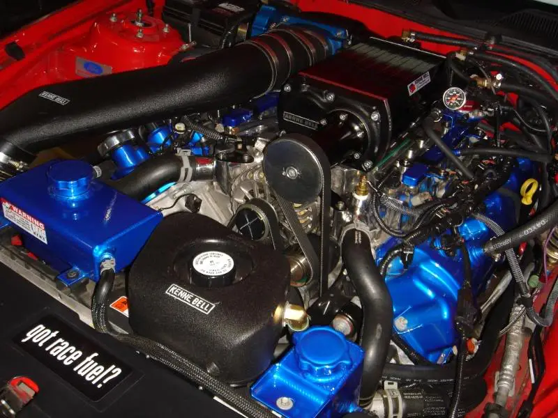

what kind of fuel you use?
100 Octane Racing Baby...
