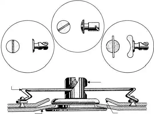

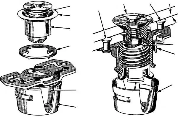

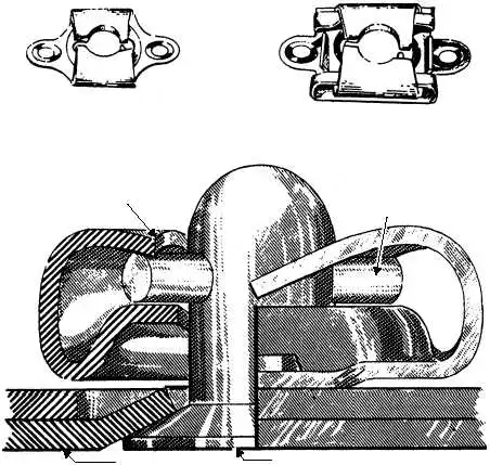

You might want to try using hardware called "Airlock Fasteners" (ltop) or "Dzus Fasteners" (middle) or "Cam-Lock Fasters (bottom). They're used in the aircraft industry to hold exterior panels on.

Yes... they will hold the hood down whether it's a DD or Race vehicle.
They can be had in chrome finish or stainless if you prefer (as well as the regular aluminum, stell, etc.). They are the fasterners that are intended for this type of application when there are no hinges etc. for the hood. In other words: They are for a lift-off type of hood (the cool looking flush mount stuff above are not desigend for lift-off hoods). Not only do they hold the hood down, when properly installed, they also snug it down (you can get them in quarter or half turn-to-click, I believe).
