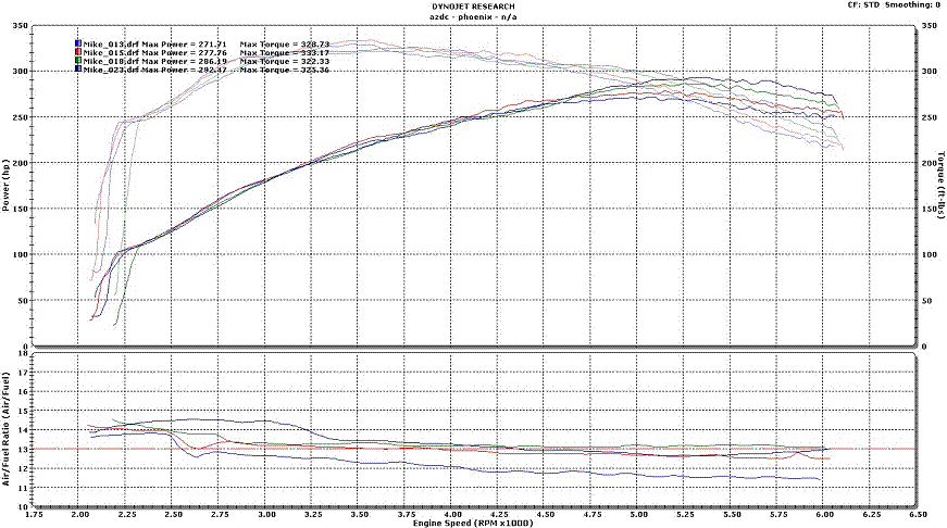

Here is a series of dyno test done on cleanLX's ported stock intake and ported stock E7 junk - if you put the right parts together, you make some pretty darn respectable power with ported stock junk.
