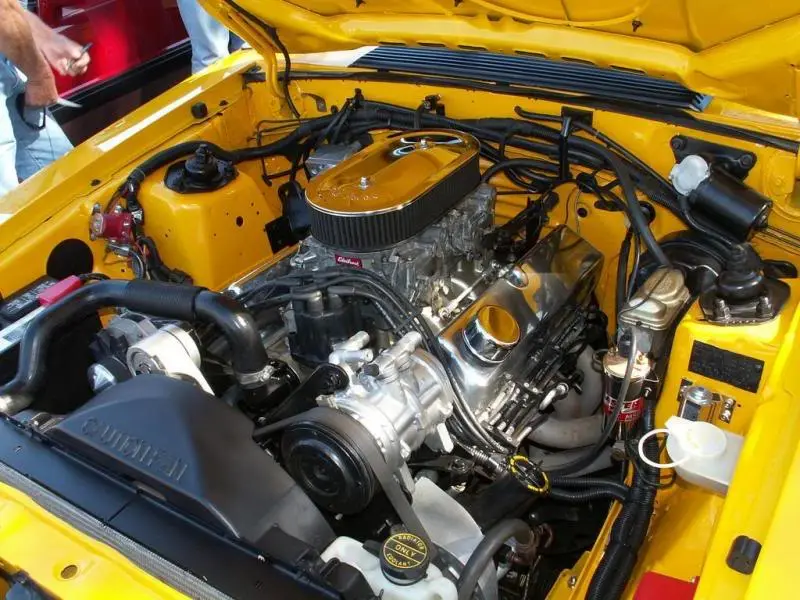

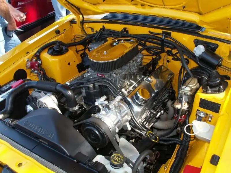

I use wire looms that are made by a company called "Made For You". They're sold through SUMMIT RACING and are totally awesome. There's two aluminum pieces (one for each side) that bolt to the valve cover bolts. On these pieces, there's plastic wire holders that are held onto the aluminum pieces with Allen head bolts. These bolts have nuts on the bottom with nylon inserts, effectively preventing them from loosening up. My brother has had his on his engine for 9 years and mine are going onto their 4th year. Neither of us have had any problems yet.
Here's a pic. Though not up close, you can see that they even keep the wires off of the top of the valve covers.
Oh yeah, those rock!!! I just checked them out @ Summit. A little pricey though but I think I may end up getting some of those.:nice:
