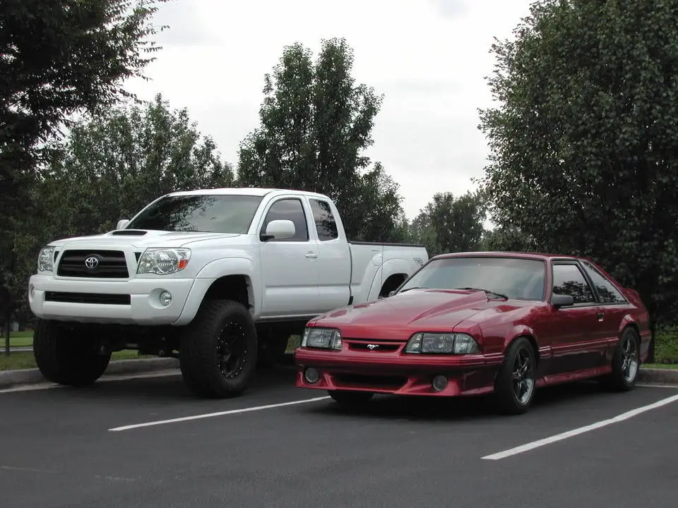

And so this thread is not completely boring, here's a pic of my car.
Ask and you shall receive...

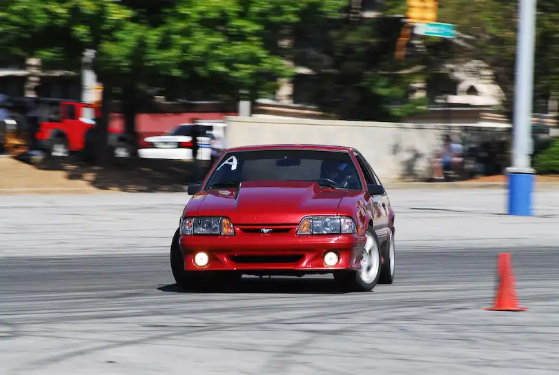

Photo was taken at a drift day a while back, notice the Atlanta Police car in the background..

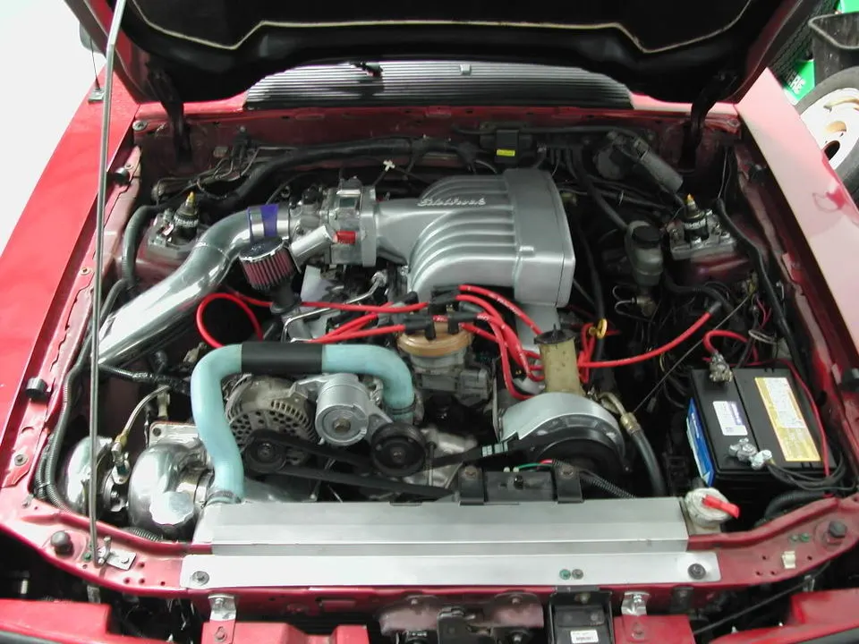

And I found a pic from when it had the turbo on it, man it was fun. Scary but fun.
That is a wicked looking ride man. Love the pic!
