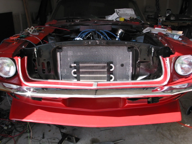

Howe makes a good one, you can even get a Fluidyne for less than those other guys. I bought a "Race Pro" radiator from Northern (very much like the Howe IMHO) for about $150. Here's a picture of it in my car before the grill went in:
