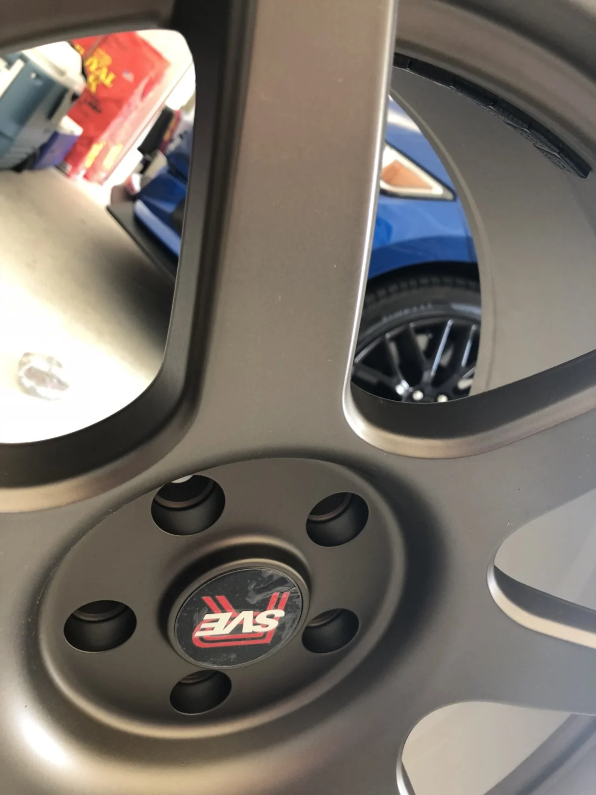

I’m switching wheels and need to buy tools as I have none.
The wheels I am getting will have a black lug nut kit with a key.
