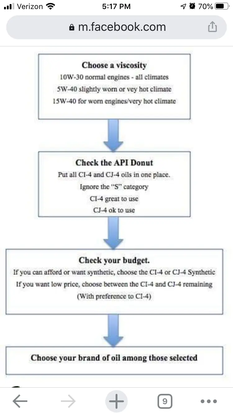

This is a screenshot of the flowchart for getting the best oils for non roller camshafts for another 60’s vehicle. Look at the Certification for CI-4 for diesel. The SL and SJ service ratings are the gasoline ratings to look for, not the newer ones.
