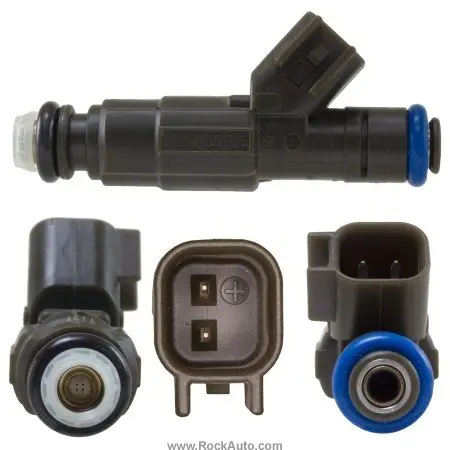

I used a set of these. I purchased them years ago off ebay, they were listed as Cobra injectors and came with the fuel rail (which I didn't use, still have though).
rockauto lists them for 99-04 Cobra, 99-02 Lincoln Continental and 99-04 Lincoln Navigator.
I picked up a set of adapter plugs off ebay to connect to my stock Foxbody harness. They are currently installed and running (haven't been out on the road yet with them due to winter).
