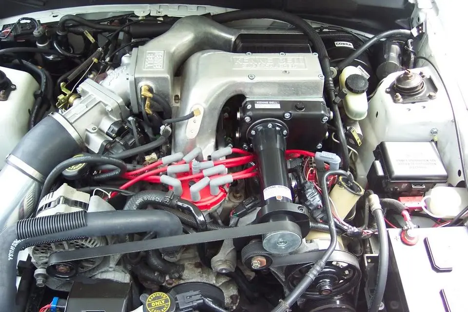

old pic enjoy...
[/IMG]
for what its worth, mine makes 8 psi, and the only thing i've done is put in a 190 fuel pump, still got the fmu, 19 lbers etc, timing at 10....i have plans for the picking up all the good stuff but I'm not home enough to get around to it...haven't event driven my car in the last month.
