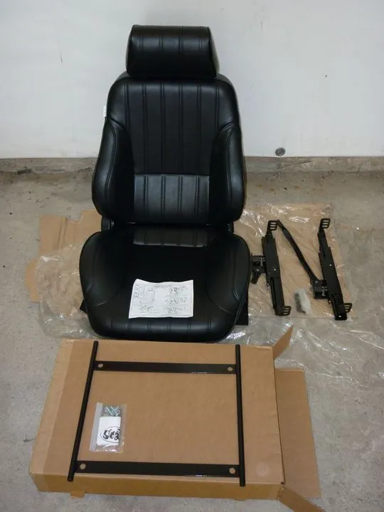

Last summer i installed a set of procar seats in my 67 fastback.:D
The quality is top notch and the installation was a simple job :nice:
The seat is about one inch higher than my old buckets. But that is no problem for me.

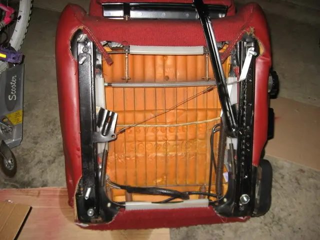

Oh, I thought about removing the seat tracks and using some 1/4 or 3/8 flat steel to mount the seats, figured that would give me another 1" or so of room. I could mount everything with grad 8 bolts although I would lose the adjustability.

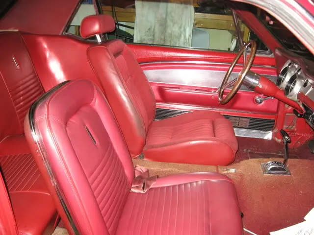

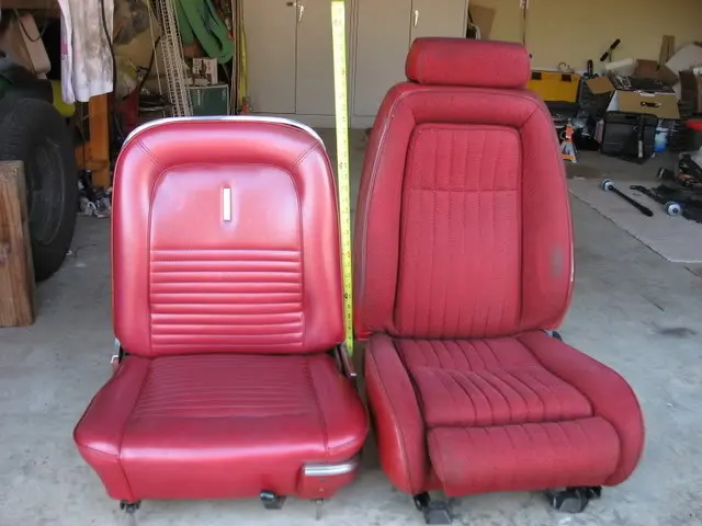

That's what I did with Foxbody seats in my '67 but only used 2 pieces of 1" wide 1/4" flat steel. Knocked the 'feet' off the fox sliders and used them, the steel was just a transition between the sliders and the floor. I moved the seat back a couple inches and now have more room than I need (6'1").
Here's a couple pics, I plan to recover with TMI set to match my rear horizontal stitched seats so they'll appear 'stock' to the untrained eye.
I have red interior so all the Scat, etc. were out since they don't make red and I wanted a more stock look with headrests (using the triangle shaped ones when done) more bolsters and recline. They'll probably cost more than the Scats or Procars when done but they'll match the interior and be the look I want. Picked up the seats in good shape for ~$60 so that was a good start.
The seat bottoms are the same height as my '67's so I'm no closer to the roof but can recline a little for more headroom (helmet).
