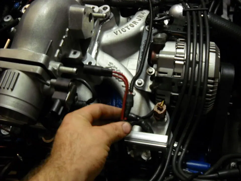

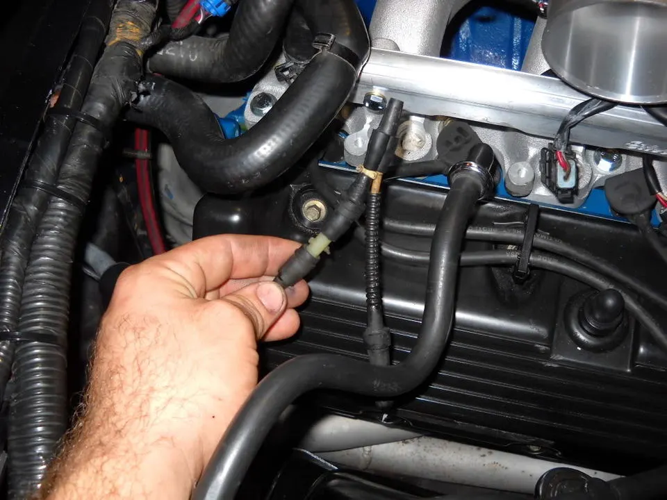

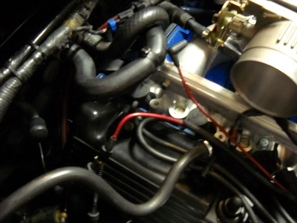

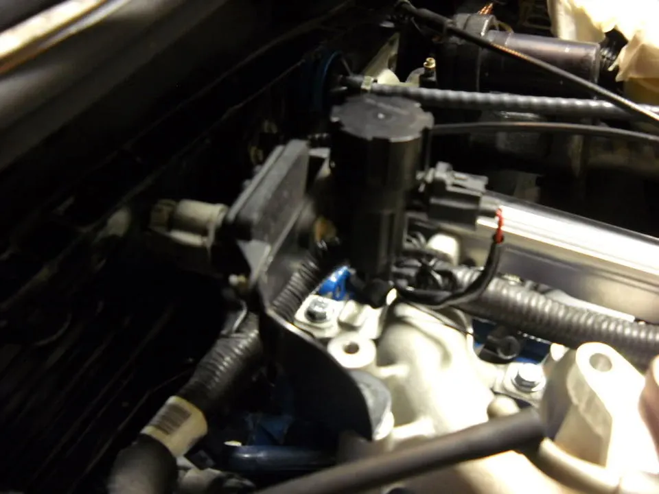

im trying to clean up my engine bay, and i want to do somthing with this terrible looking red plastic vacuum line, i know the 1 sensor had 2 lines going to the egr tube, but i have an EGR delete kit,ti dont know what the other sensor is? and the line goes from the other senson, to the upper plenuim, then to the stock fuel pressure regulator, and a misterious line comming from the fender, (see pics) is there any thing i can do to get rid of this stock line?
the 2 sensors
line from fender
line to upper plenuim
to the FPR and mysterious line:shrug:

The 2 sensors are for the egr... When the new motor was put in my car they removed the egr.. All u should need is a line from the upper plenuim to the fuel sensor.. not sure about the mysterious line.. I have a trickflow track heat intake on mine.

im the one that did the motor job and deleted the EGR, so i can take those sensors and bracket off? and the egr is deleted in my tune, i was hoping all i need is a vac line to the aftermarket fuel pressure regulator.
