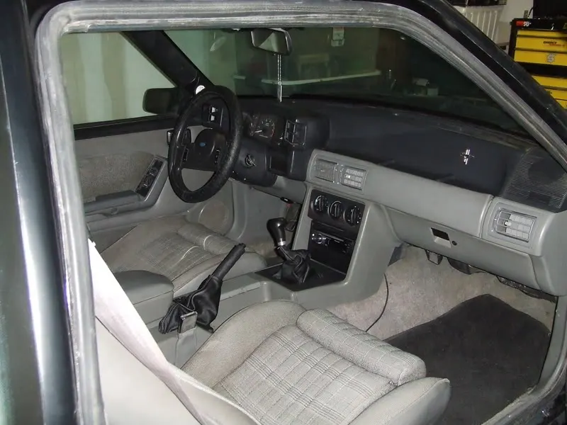

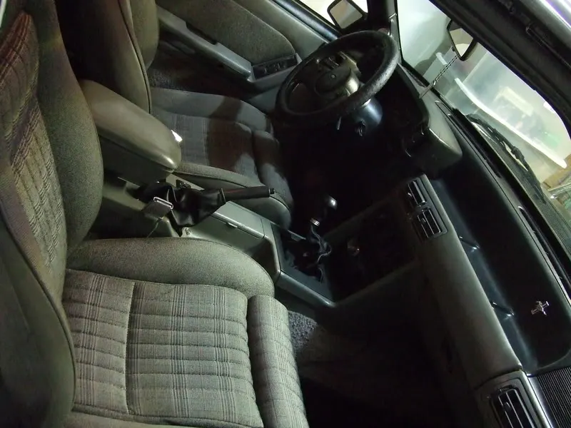

Another Redline Goods customer here; both the e-brake and shifter. A friend of mine saw it and fell in love and replaced the one in his SN95 with the same stuff.
Pic in case you haven't seen 'em:
No problems with fitment or anything.

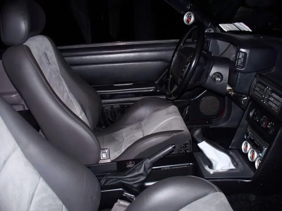

Another one here for Redline Goods. I had them make me a black/gray boot with alternating black/gray stitching custom to match the black/gray Cobra seats in my car. I also have their E-brake boot.
Mike and 25th, the boot can be attached to the stock bezel very securely, as it is in my car. First, remove the old boot and pry out the staples that attach the old nylon boot to the old metal ring-- this ring will be reused. Now, line up the holes in the redline goods boot with the holes in the old trim ring and use heavy wire (almost like a staple) to secure the boot to the ring. Feed the wire through the holes and then twist it closed tightly with a pair of pliers. Bend the sharp edges in, drop the new boot/ring in, and you're done!
