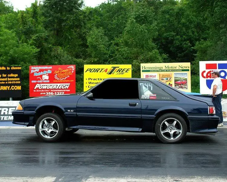

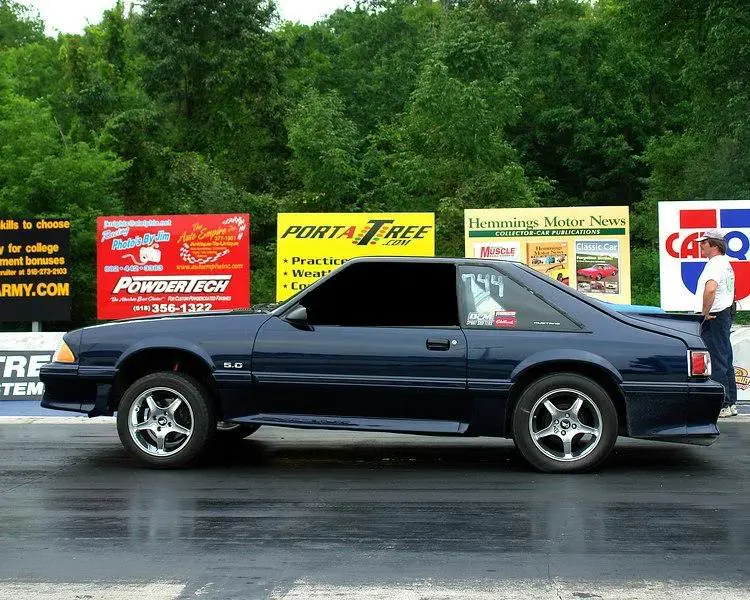

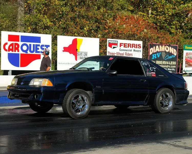

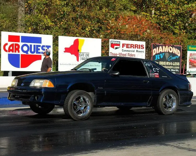

Here is a couple pictures of the car launching.
I don't think it squats as low as I thought.
Do you think the rear is squatting too much?
