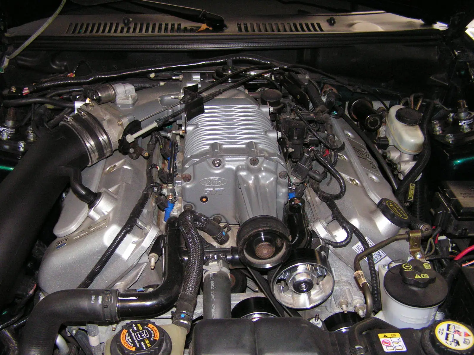

Here's an engine shot. The car color is actually called Mystichrome, it changes colors depending on what angle you look at the car, from purple to teal, to blue, to green. I bought it this past Jun with 12K miles, it's at 16K now. Thanks for the compliment! .
