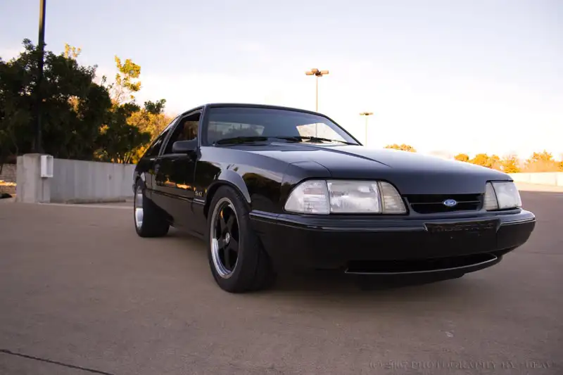

Im going to be getting some black sc wheels at the end of the month, im getting 17x10 in the rear but i dont know what to run in the front. I like the 17x9s because they have a lip unlike the 17x8s which the spokes are almost flush with the edge of the rim. But i want to make sure the 17x9s wont have any problems up front?
Heres an idea what its
