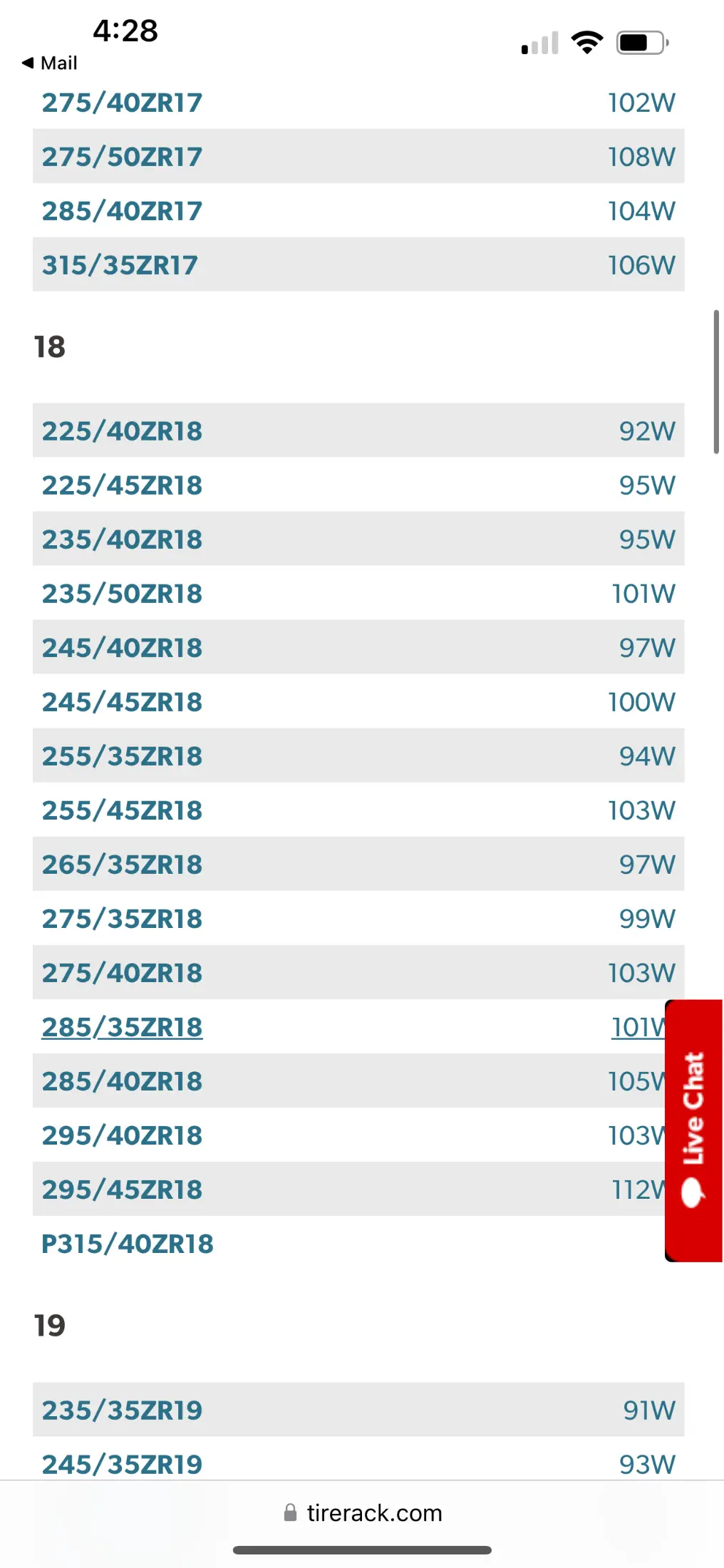

Can people who run a 18x9/18x10 staggered wheel setup let me know what size tire I should run? I’d like for the front and back wheels to be seated in the tire roughly similar, and I want the tires to have a good looking sidewall.
I’ve attached the sizes the nt555g2 below. 275 is the width I want to run in the back so I can get the most traction, so I just need to know what width front tire to go with that, and then the sidewall sizes. Any help is appreciated thanks.

Use that to mix and match. It's going to be tough to get the front and rear height the same.

As a starting point i'd probably look at a 275/35/18 (or a 265/35/18) for the rear.
I used a 225 on an 8.5 front and it was stretched, i went to a 235 and it's better (a 245 would likely be better), but you have a 9, so i don't see too many scenarios where you don't need a minimum of a 245, but possibly need a 255.

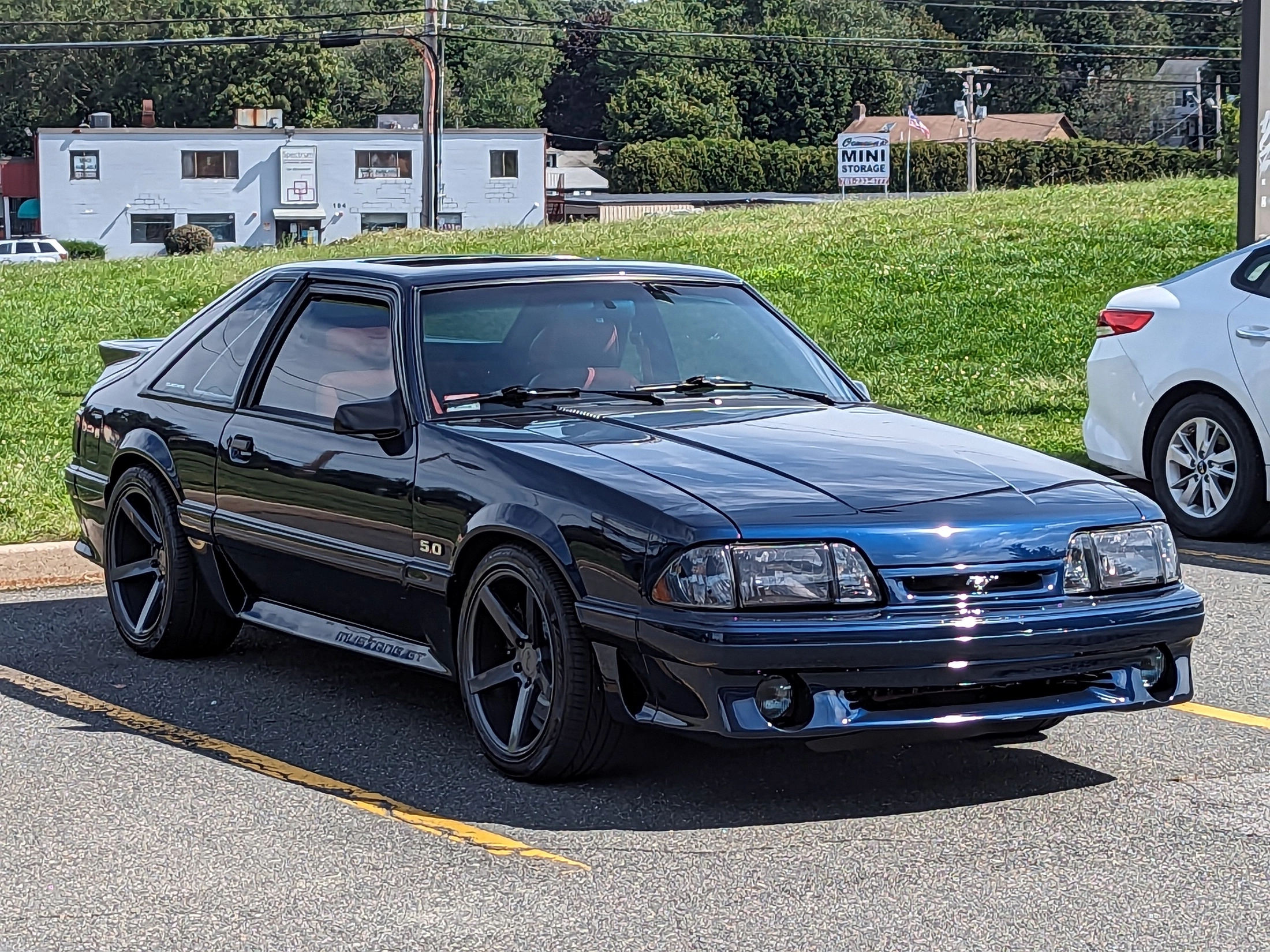

I run 285/35/18 in the back and 245/40/18 in the front
I did add rack limiters in the front and remove quad shocks in the rear.. no rubbing

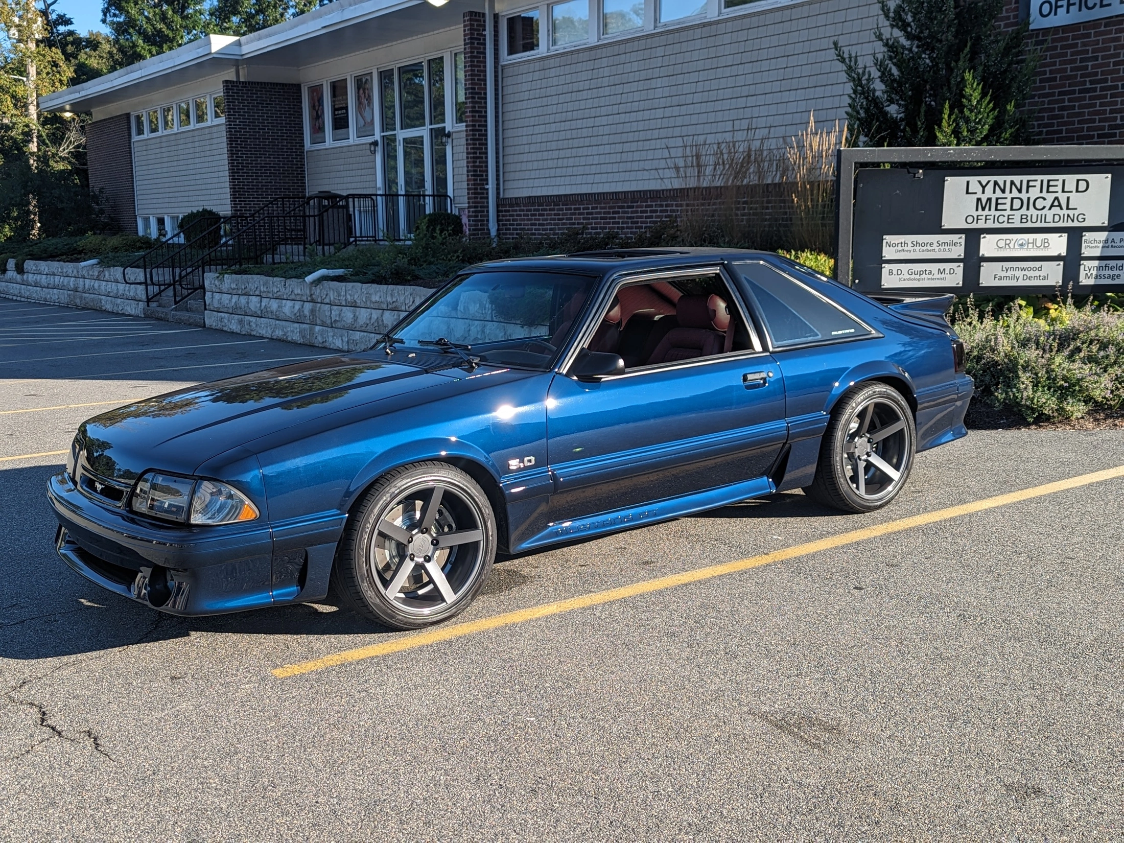

In the summer time, i go to the dunkin donuts right across from where you are parked pretty much every Sat/Sun morning.
You're right down the street from me.
Well, i don't go there anymore since it burned down.

245/40/18 in the front on my 18x9's. It's pretty tight with coil-overs, so not sure i could get much wider on this wheel setup.
My rear wheels are the same, but with a wider tire size

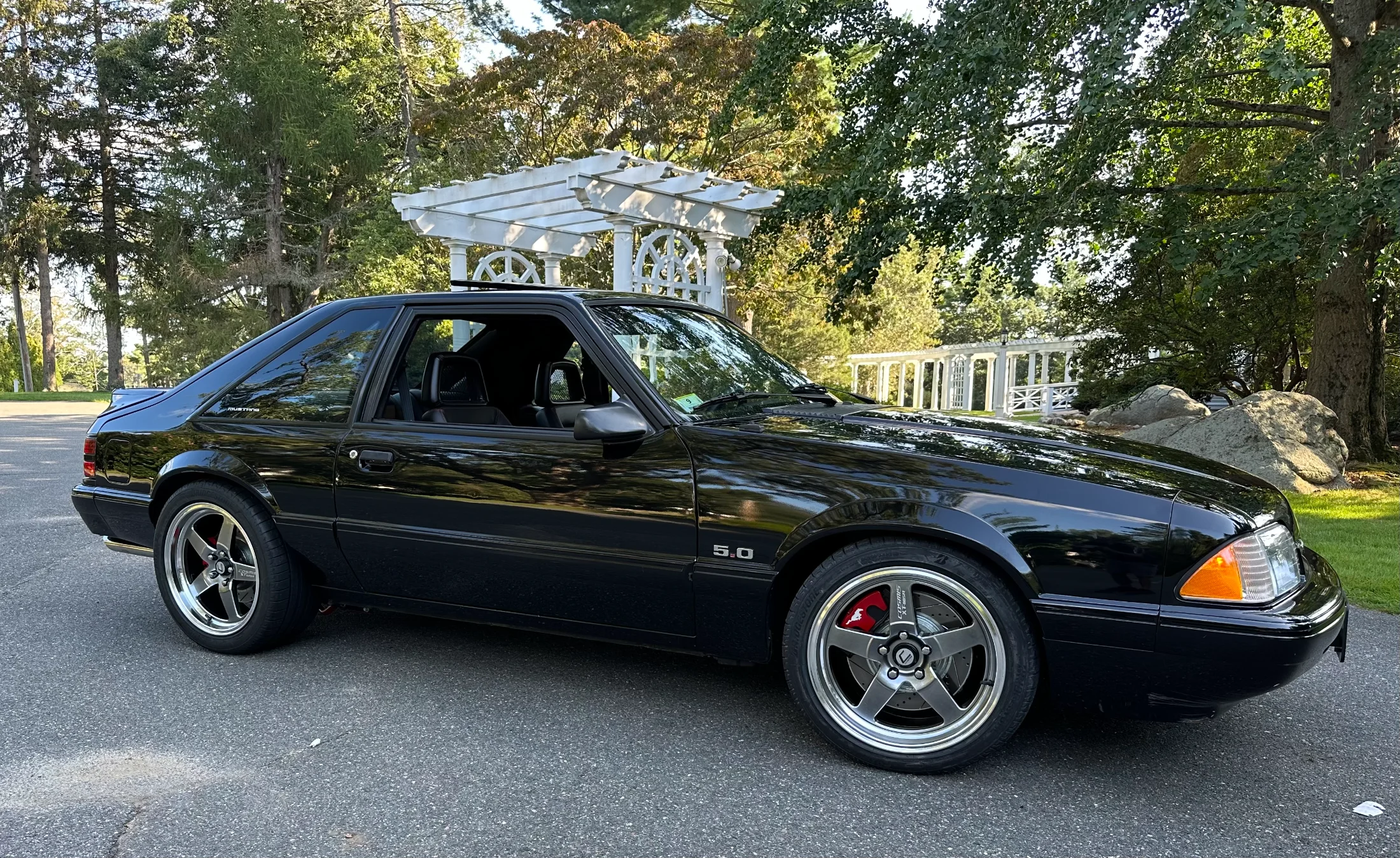

I actually don’t have these wheels on this car now. Put them on the other Mustang
Reactions: Noobz347
It is a good looking car and so are the wheels.
But it's also the reason i stand by my opinion that dished wheels don't always right on a fox, especially on the back.
Which is why i don't like the stern replicas. Saleen used 4 even wheels, not 2 fronts and 2 deep backs.
Foxes just look better when the spokes go all the way to the tire.
I don't think it has anything to do with wheel diameter.
