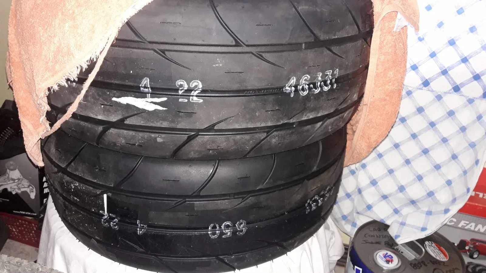

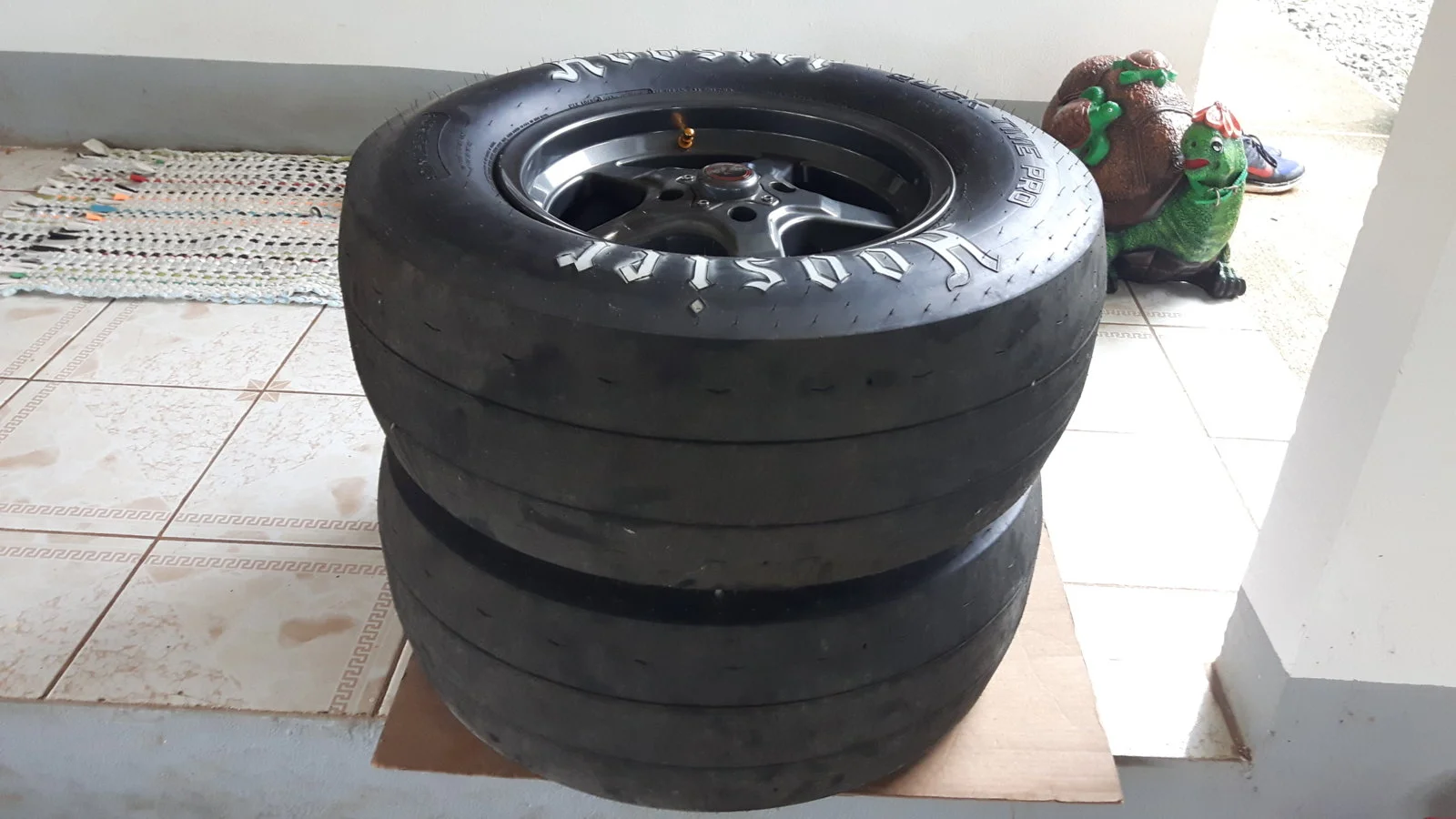

15 x8 .....i run Hoosier Quick time pros 27x10.5-15 with 373 axle...and for street M/T ET Street SS Drag radials 255/60-15...the Drag radials might work better for you...

@marcelo you have a pet turtle? COOL!
what da heck do you feed that thing? Small children? Squirrels?
