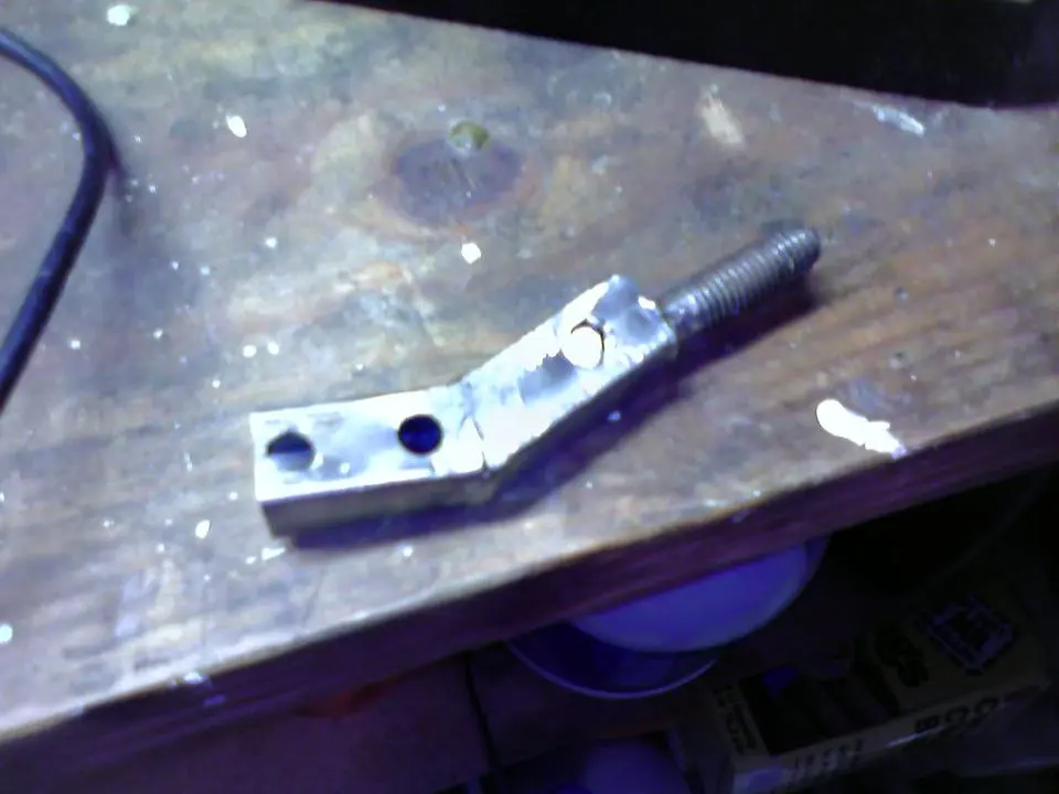

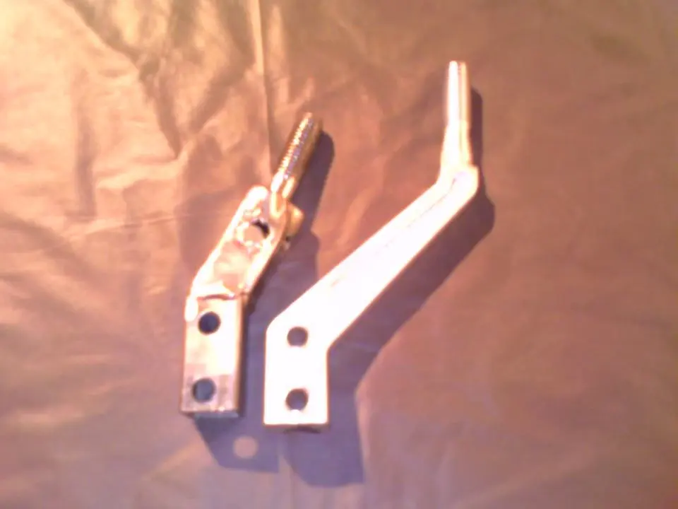

I took my shifter handle to home depot, and compared till I found exactly right, I made my own as well, just gave it toa friend for his car actually. Here is what I made. I took a bolt that had the same threads as the handle, drilled cross holes in the body of the handle which was 1/4 inch steel square stock that was 1 inch by inch I believe, and welded the bolt to the holes and filled the holes with welds, cut it to the angle I wanted and welded the two stock peices together and viola, a custom handle, bout 5/8 the size of my tri ax!
