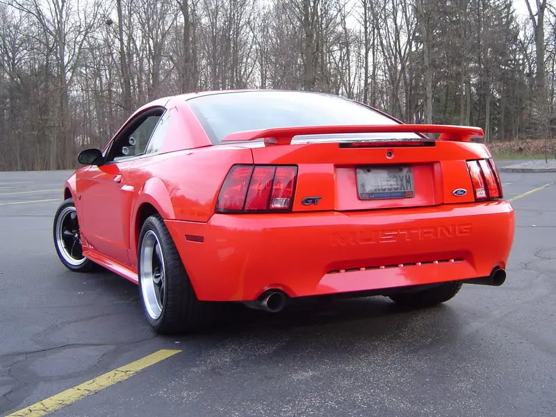

315s on a 10.5" rim. Best pic I have from the rear that shows how they look, pretty much even with the fender. Looks the best IMO.

You don't want wheels or tires sticking out past the fender. If you have stock wheels, the meax tire you should go is a 255. If you want 275's or 285's get a 17X9 wheel. If you want 295, 305, or 315's you should get a 17X10.5 wheel. Even with that size, it will not stick out past the fender, but it will fill the wheel well more.
