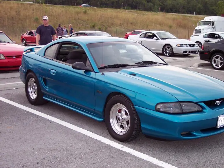

I used to run the same sizes as Last5.0 until I recently got new wheels. Now I have 275/40 on front and 315/35 on back.
What is the width and backspacing on your front skinnies Last5.0? I want to get a set but don't want to have problems with them rubbing on the brake calipers. Yours look very nice on it.
Mine are 3.5" wide and they only come in one backspacing, something like 1.75". They do not clear the brakes unless you run a spacer or modifiy the caliper. Without modification you would need like a 1/2" spacer. If you remove the crossbar on the caliper you only need like a 5/16" spacer. If you grind the caliper face so it's flat and not "humped" you don't need a spacer. I've done all the above years ago and I believe in that pic I had the caliper ground flat and no spacer. I've since sold my stock modified calipers and switched to the '99+ dual piston PBR calipers and run a 3/8" spacer without modifying the caliper at all and the wheels still stay just inside the wheel well.
BTW, that pic was taken during a launch so the whole car is raised up on it's way to getting some daylight under the tires. The car sits real low normally.
If doing it all over again, I would just get a bit wider wheel, like a 4"-6" with enough backspacing so no spacer or modification is necessary
If you have Pro Stars, it doesn't matter what the backspacing is, it's going to rub the same. The hub rubs on the caliper. You can get different drag wheels that eliminate this problem, but not Pro Stars.

True, come to think of it the way the center hub part of the ProStars are made there will still be front brake interference no matter what back spacing you get...lol. Plus they require longer (3 inch) studs to be safe due to the thickness at the hub.
Might be better off with some Telstars or Greg Welds or something.

I posted that for the OP. I kind of thread jacked with the skinny question. I'm looking for skinny wheels and backspacing info.
