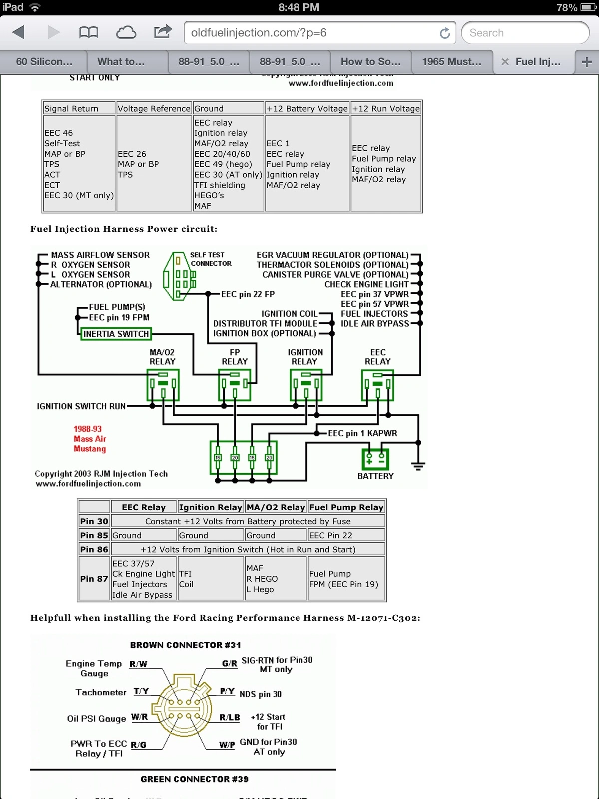

Not to steal thread but was hoping to get some help. Trying to finish install of 1990 efi, auto tranny, auto o2 harness with auto ECM. Does the nss go to pin 30 on auto car from nss and is it a ground or hot. I've wired my system like oldfuelinjection.com wiring harness page six.

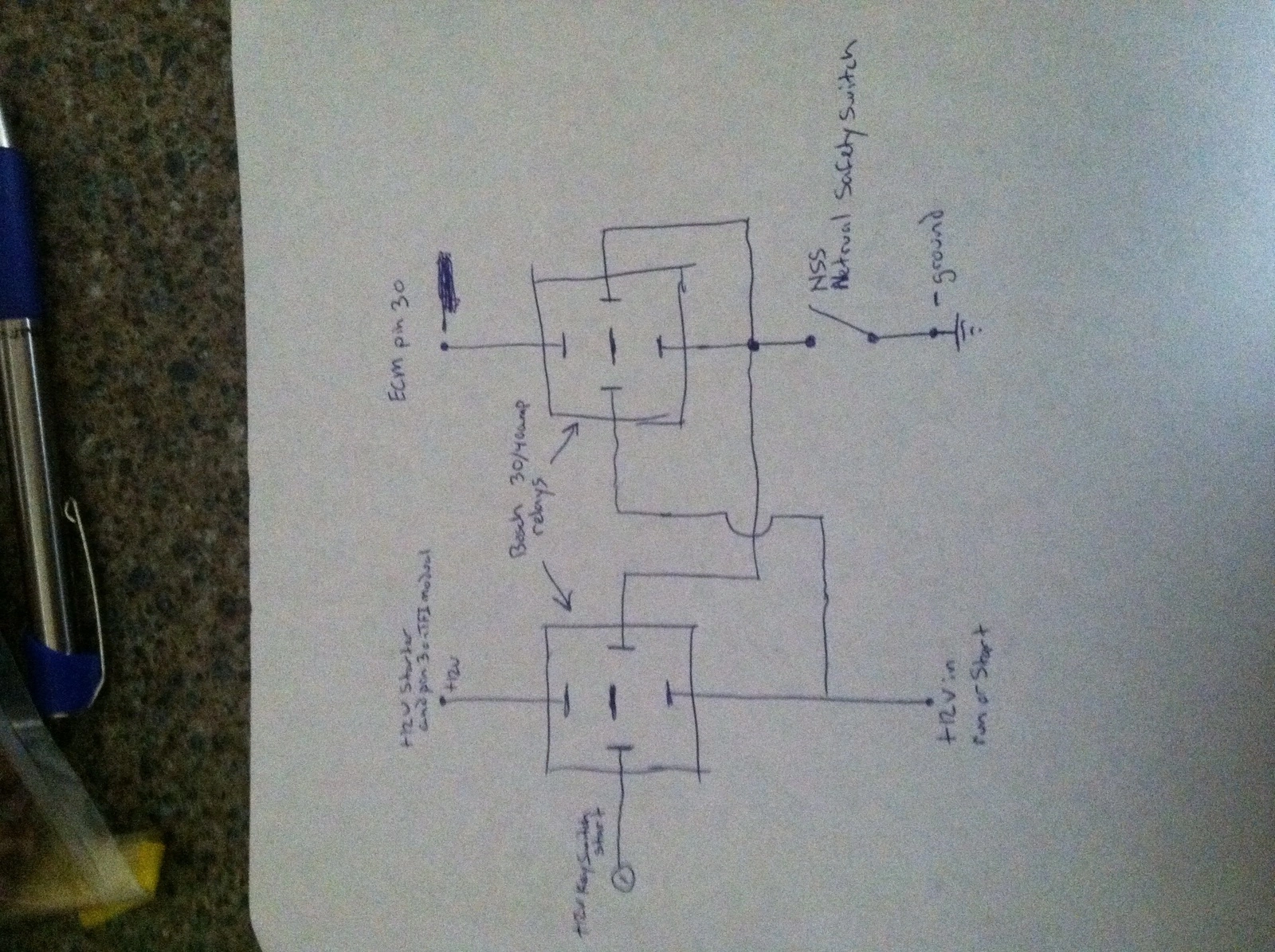

Nss has to be negative feeding to pin 30 on ecc. Will post pic on how to wire doing relay for starter and ecc later
