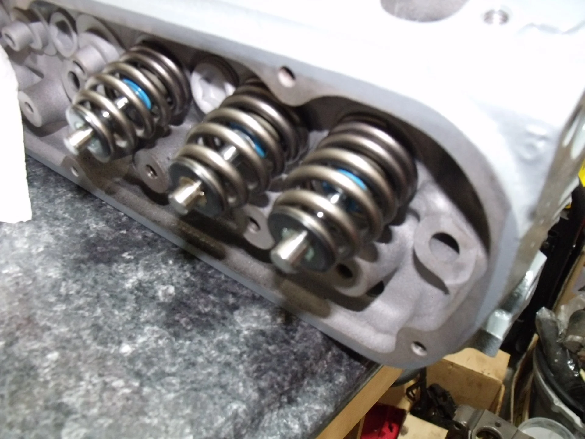

My heads are speed master 190cc, 2.02 intake 1.65 exsaust valves, with a 64cc combustion chamber.
So my question is; if I plan to stay n/a should I go with set of gt40 heads??? I feel like I'm giving up a lot of power as I'm losing compression with the aluminum heads.

The Gt40 heads are around that same combustion chamber size but the valves are smaller, the P heads are about 61 cc (IIRC) so there is a slight compression bump, but there's more to it than getting the compression higher.

With a stock bottom end those heads are going to get you about a 9:1 compression ratio which is stock. If you can mill them (I do not know the deck thickness but maybe you can call them and see if they can be milled and if so how much) that will provide the most gain. Realize that when you mill them you may end up needing to mill your lower intake to get things to line up. I had to do this with my Cobra lower to match the heads on that motor.

I'm running the Gt40P heads. If you look into it they are actually better than the 40's. Just make sure you upgrade the springs. That's the weak point of them.
The GT40P’s have a smaller header selection and have the spark plug angle/boots issue. Both minor BS stuff IMO and a great head for the $$$ especially if you can score a set off an Explorer.
