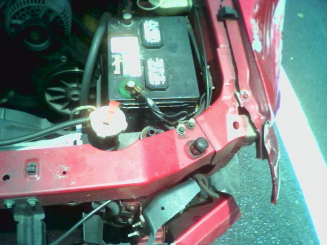

Back in May I got into a minor... well somewhat minor accident with my 1994 V6 stang. I had just done a headgasket job on it not a month before as well as installed a new transmission. Interior is perfect, front bumper was scratched but I was going to replace it and sell the car, until, of course, I crashed it.
Anywho the crash was strong enough for both airbags to deploy, even though the impact was on the driverside front. Maybe the impact was at about 35mph, after sliding for 55 feet begging my ABS to work. They refused.
Now I'm wondering if I should fix the car, which would require me to replace everything up to the radiator, and the two huge shafts that hold the entire front bumper, they run backwards into the frame. I'm not sure if they're bolted in or welded, haven't looked yet. Then I'd need the actual front bumper and a driverside panel, and a damn good alignment.
The hood wasn't killed in the impact, paint just came off, it was mostly on the side, it pushed my battery support into one of the pulleys, just to the point where the pulley woudl slightly touch it, but after i ran the car for a minute it carved it's self some space.

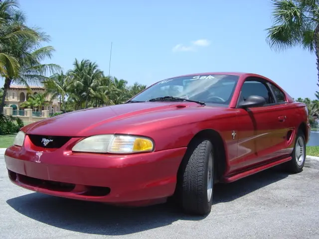

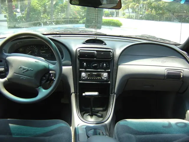

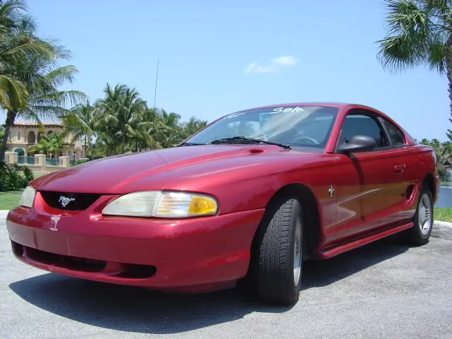

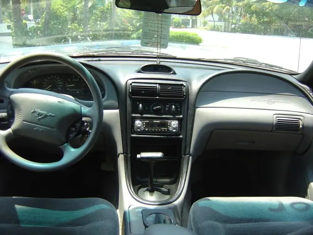

This is before

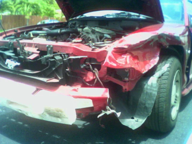

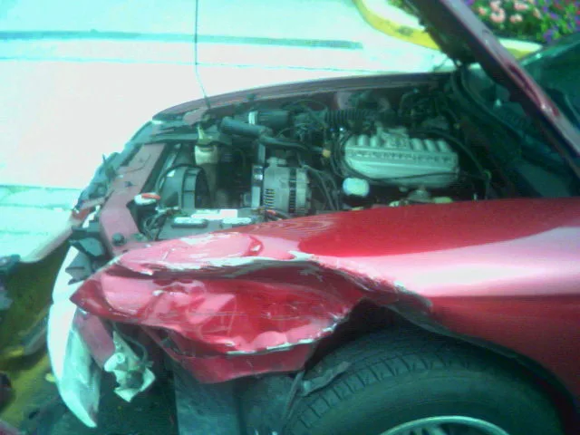

It's taking so long for this court thing to even BEGIN, let alone finish! Actually my lawyer must take care of something beforehand, I was written a citation for reckless driving when I really shouldn't have gotten cited so harsh for something so minor. So once she gets that out of the way I assume we will begin the actual court case.

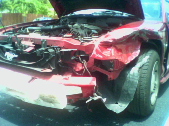

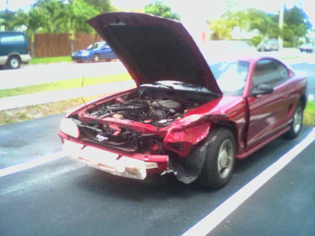

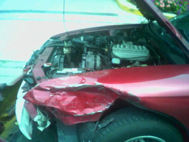

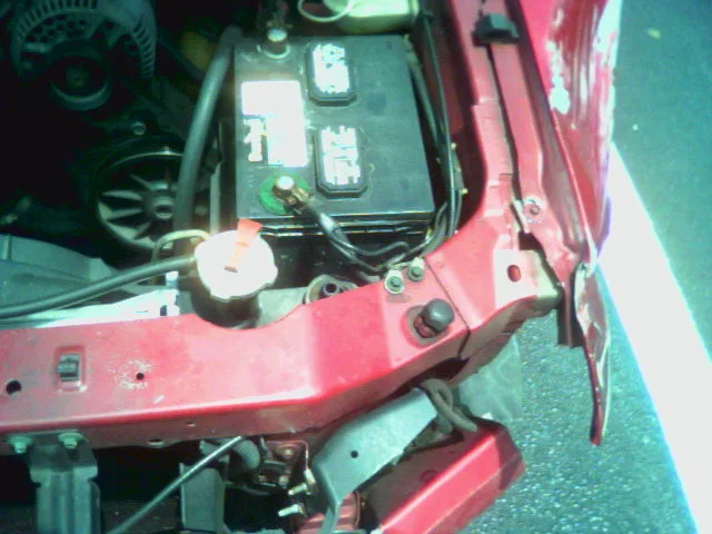

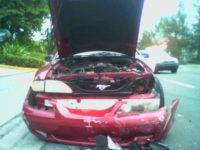

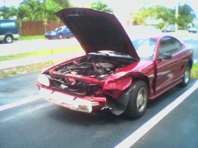

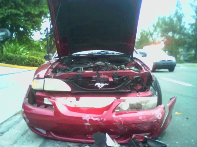

Of course when I said 'Fix my self' I meant going to the junkyard and taking parts from another 94 stang, for the most part atleast, as far as bumper, headlights, grille, fenders, etc So I won't be paying full price
Well, just looking at it, here's my "guesstimate"
Fender $250 (w/o paint)
Headlamp support $200
Headlight $100
Corner lamp $75
Core support $150
Bumper cover $299
Metal bumper reinforcement $100
Airbags $400
Airbag module $200
Airbag sensors $250
You do the math.........

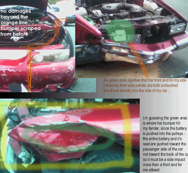

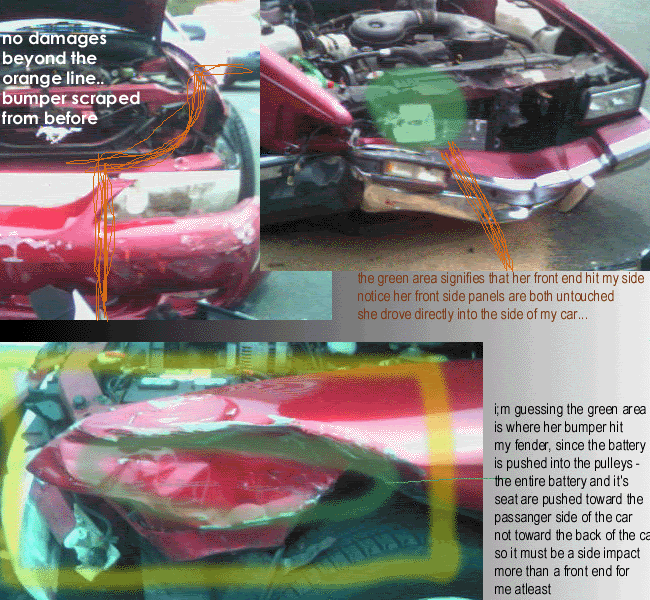

That doesn't look as bad as it could have been. Alot of body damage and such. I'm still having a hard time understanding how this accident happened. Did she turn into you? Did you both get tickets? If you were going 5 above the speed limit, that wouldn't be considered reckless driving. Heck, I don't think they would have been really able to tell that you were going 5 miles above at the accident site.
Actually from the math, Square root of (30*distance*drag factor) = 33.985 mph Now I compensated an approximate drag factor for dry asphault. Depending on what your actual speed was, if you said it was 35 mph, then you were going about 68.9 mph. Is that reckless......I don't think so....but I guess it's the officer's opinion. Now if your brakes weren't working efficiently, and only had, say 50% braking efficiency, that would further lower the drag factor, lowering your speed, by the officer's calculations.
Where are you located? What state? I have a police officer "technical crash manual" that may be able to help. If you got a copy of the crash report, specifically the diagram and measurements, I could do a workup for you and let you know what I come up with
It was a residential area, somewhat curvy roads, 3 lanes for me in my direction, a median, and 3 lanes in the other direction. Not including turn lanes. She was in the turn lane , opposite direction of which i was moving. I was in the right most lane, I saw her start pulling out so i moved to the left lane, thinking it'd be safe and that she'd see me. She blocked that lane too and then i went to the next left lane which was the last one, and i saw she wasnt stopping, slammed on the brakes, i mustve been goin 35-40mph when i slammed on the brakes, they locked up immediately and i went sliding for 58 feet or so the office said. She was crossing all 3 lanes so the front side of her car slammed into the corner of mine, well i slammed into her.
The problem is, a few stoplights back a witness saw me launch off the line, i went up to 50mph and cruised the rest of the way. When he finally got to the crash he told the cops i was going 80mph. He didn't even see the crash he just saw me take off of a stoplight.
Cop first told me I was doing 60mph, I asked her to measure the marks assuming I was going 35mph right where the marks start, then she wrote on the report that i was doing 40-45mph, which i really wasnt, i just didnt slow down because i thought she'd see me.
Thoes prices you showed me are for brand new **** though, junkyard is a swell place!
