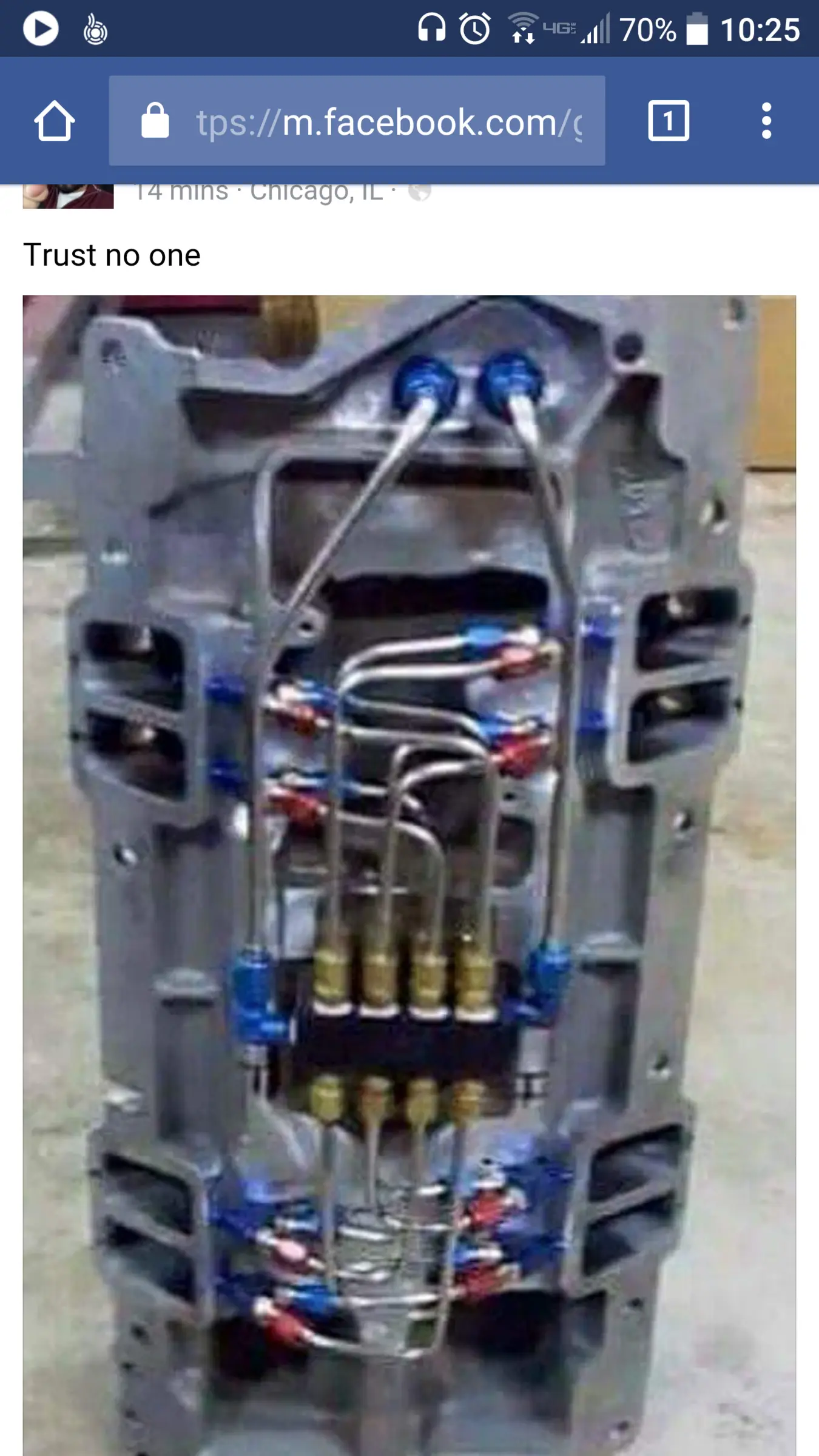

How about rebuilding it the way it is and hide about 150hp worth of nitrous on it?!
