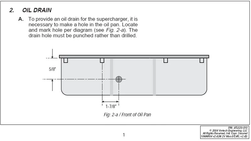

Drilling it, is incorrect way to do it, the metal pieces are microscopic, and you will not get them all out. Plus you are supposed tap the front of the pan, where there's very little oil. The vortech site says do not drill the pan. Plus the pan is thin, and there's hardly enough material to tap if you drill.
Why even grease the tap your just going the oil when you done anyway? There are places for metal to get trapped in the pan like around where the baffles and the crank crapper are welded to the bottom of the pan.
http://vortechsuperchargers.com/pdf/manuals/4FH4FL218im.pdf
This is from vortechs site and a drain is a drain.
They thread starter can do what he wants, but I highly reccomend not drilling the pan while it's still on the car.
I wouldnt/didnt drill either! You need that material you push in with the punch to tap. An oil pan isnt thick enough by itself to drill and tap, you would need some sort of additional metal to support the threads.
If you want to spend the 26 buck on that punch, go for it. I made mine with a grinder and a piece of rebar.
