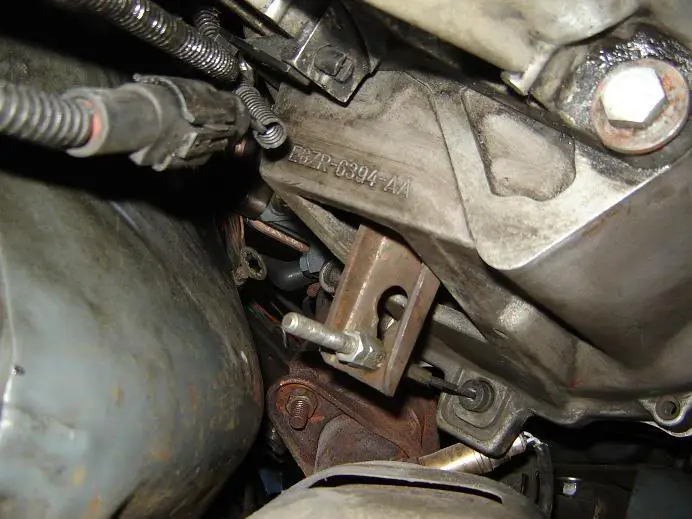

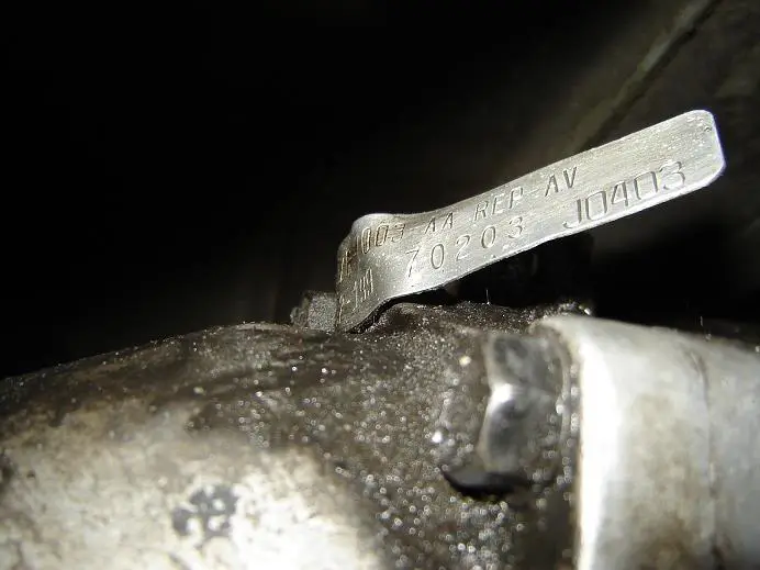

I am trying to figure out the speedo gear that is in the tranny. Will any of these numbers tell me?
tag on tranny
numbers on bellhousing
Nevermind, thought you had an 89. It's the 87-early 89 T5. 7T speedo gear
Tranny
Part Number 1st 2nd 3rd 4th 5th R Torque Capacity
lbs-ft Door Tag
Code
5-speed T5 (1987-89)7
E6ZR-7003-FB 3.35 1.93 1.29 1.00 0.675 3.15 265 2
7 - This transmission was also factory-fitted to late-1986 V8 Mustangs. The output shaft has a 7-tooth speedometer drive gear.
