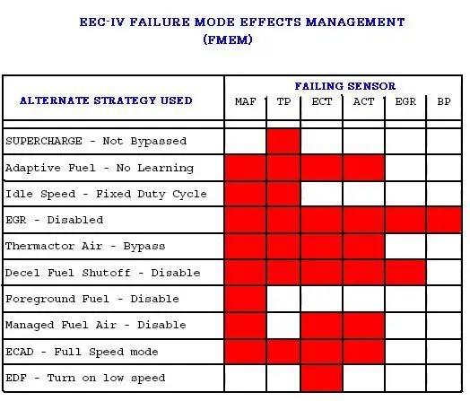

4.71 vdc is above the 4.6 vdc maximum threshold for the ECT or ACT circuits. IOW.... the system is within its working range as far as the ECM is concerned. Also keep in mind that when you start the engine with a hard failure code present (ECT is one), the system will switch to Failure Mode Effects Management (FMEM) strategy.... affecting idle, A/F, spark advance, etc.

Isn't the coolant temperature supposed to raise when engine has been idling for 5 minutes?...... regardless of the ambient temperature? The circuit is within specifications. The fact that you have a code 51 showing with ECT disconnected + if you install a jumper wire at the ECT connector pins, run a KOEO, and have code 61 getting logged....... it's the proof the ECT circuit is within its acceptable working window, the ECM logic will do the appropriate scaling to the correct temperature. IOW.... the culprit or cause(s) for the stalling symptom is(are) elsewhere. LUK

If it was running in Failure mode, would the Check Engine light be on? Is there another way to tell. It should at least store a code I assume.
