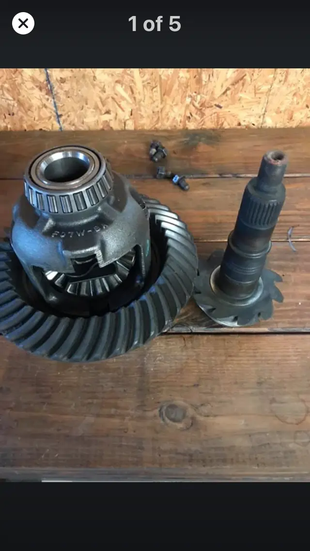

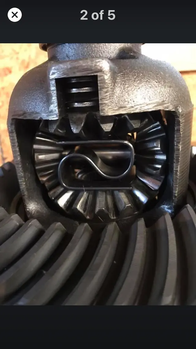

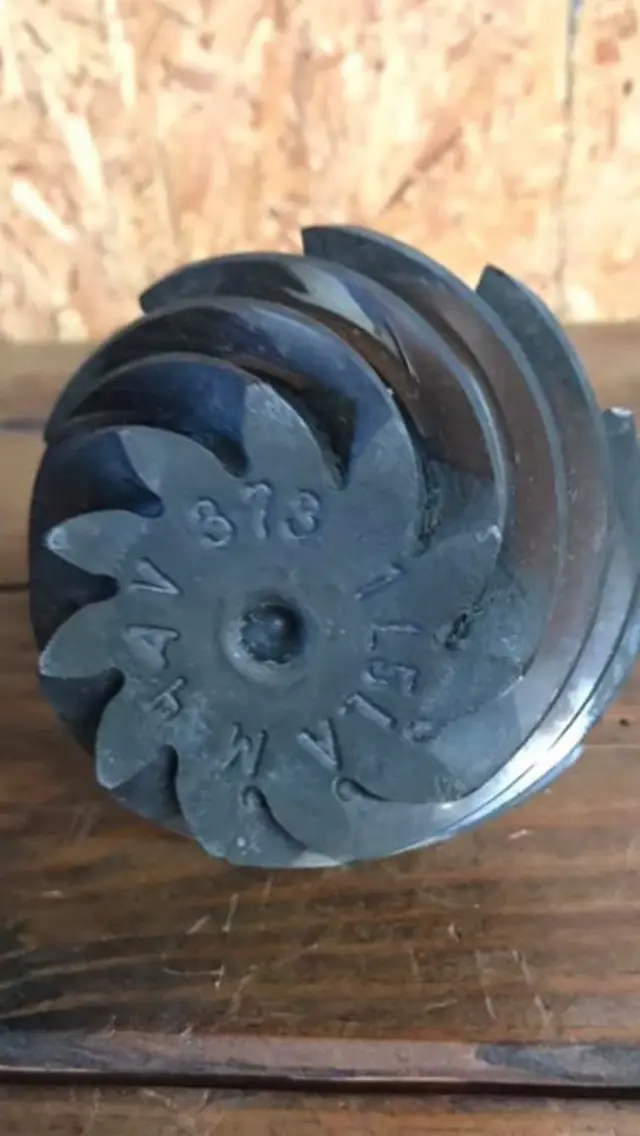

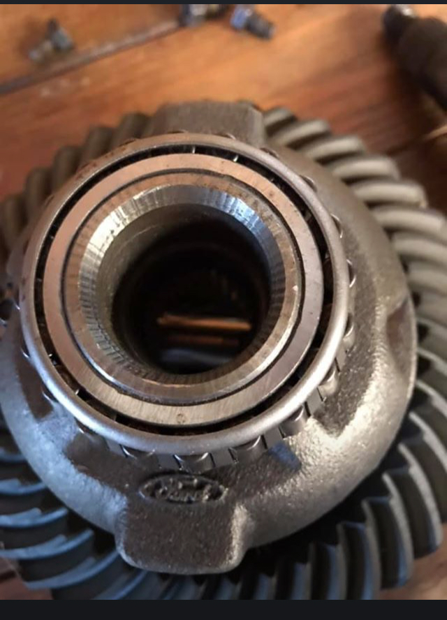

Found some parts - on my Stock 91 do I have 28 or 31spline ? Does this seem like a good price ? Does it look to be in good shape ? $100

As for your pics, it doesn't look horrible to me but I question the wear on the pinion gear. It's a little hard to see the wear pattern on the ring gear, but it looks like they didn't have the pinion depth set up correctly for however long they ran it. I think it looks serviceable though....
