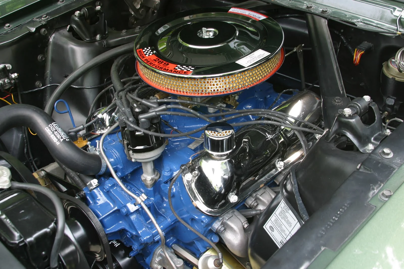

Oh, you want to identify a K code. Well, the 4100 used on the 67 K code was a the same as the earlier K 4100, with the 1.14" venturis. There was no 67 A code 4100, it had been replaced by an even smaller 4300, clearly inferior, but would pass emission standards.
And no, you could not specify which carburetor you got when ordering your car.
The external cues to identify the K code were special chrome air cleaners and valve covers, large alternator pulley, dual-point centrifugal-only distributor, manual choke 4100 carburetor, large harmonic balancer, and low-restriction exhaust manifolds.
The A and K code engines used the same iron intake manifold.
The reason I am asking, is that I want to "create" a 1967 factory looking hi performance engine compartment for my 67 Cougar.
I don't think there is any difference for the Cougar engines, and so I am trying to come up with something that would make somebody that didn't know the difference think about it.
