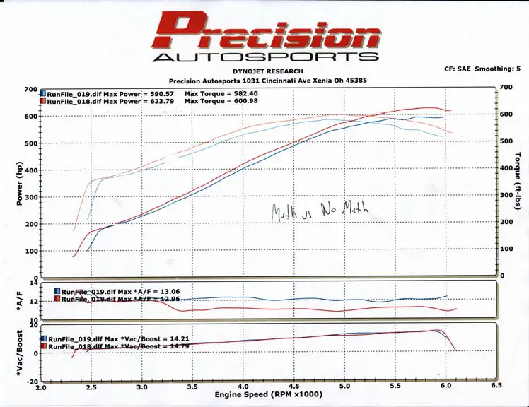

Now have 623rwhp
3/17/2012
347 Ci
Dart block SHP
8.5 to 1 Compression Ratio
Dyno Tuned SCT Chip
TFS TW Heads ported
Systemax Intake Ported
Intake Spacer 1" inch
Vortech V-2 SQ With 2.85 Pulley
Anderson Power Pipe
Maxflow bypass valve
Snow Water Meth 2 Stage
75mm T/B
MAF SCT Big Mouth BA 3000
60# injectors
Steeda 19 Cam
H&S 1.72 Roller Rockers
MSD 6al
Glenns Performance fuel rails
Glenns Performance Dual Walbro sys (1000 hp)
JBA ceramic coated Shorty Headers
Dynomax Ultra Flo SS Exhaust
Mac Hi-flow cats
Spec 3+ Clutch
TKO 600
Victor EFI intake or box type upper or go with the 90 degree elbow on a 4 barrel intake conversion.
Custom camshaft should really improve things over your current Steeda 19.
A NOS or similar system will get you there easily.
Sell the Vortech and go turbo.
+1 on the Turbo. It's going to be really hard to push the blower any farther or get the engine to breath enough to get that power. The bottom line is that the blower you have will only flow so much air.
Kurt
+1 on either a turbo or an upgrade to a bigger blower. That S-Trim just isn't going to do it. With the Meth kit you are about 180hp short of 800. There is no way a cam of any kind is going to make that kind of power increase. Also, you may want to take into consideration that you will be pushing that TKO600 beyond its limits so that will end up being a required upgrade as well sooner or later.
The cam will help but I wouldn't expect huge gains with that combo... like said if a custom can causes you drivability issues some things wrong.
I figure with 17% drivetrain loss your making about 735fwhp. Are you talking 800rw or 800fw? With a more aggressive tune your meth gains could be higher I'd use a 80% mix as well.
How ported are the TFS heads? Besides adding a lot more boost your gains with a big cylinder head and proper can could yield good results.
800 can be made with a worked Holley a high port or AFR 205/225, and 20psi with a YSI or F1R blower...actually you can make well over 800.

this right here. i think swapping out the heads and getting a larger blower will get you there if not really darn close. I think ultimately you could do it with just boosting it to all hell, but the heads will make it easier.
