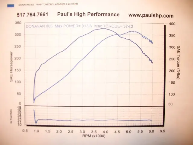

Let me give you guys my facts with my mods. I have 1 5/8" LTs with the rest of the exhaust and upgraded fuel (42# inj, 80mm maf... check my sig) and on the stock longblock I made 313 rwhp and 374 rwtq. Look:
In one of the stickies with stangnet combos there is someone with an aode running the same basic parts as me plus an aftermarket intake making over 350. From what I have seen of others H/C/I dyno graphs you can't argue with these results. My driveability is great, but with the 42# injectors, 18" wheels and cobra brakes I get 15.x mpg. Take your pick, each has their ups and downs, but my vote is for the blower if you want the most horsies for the same (or at least similar) buck.
