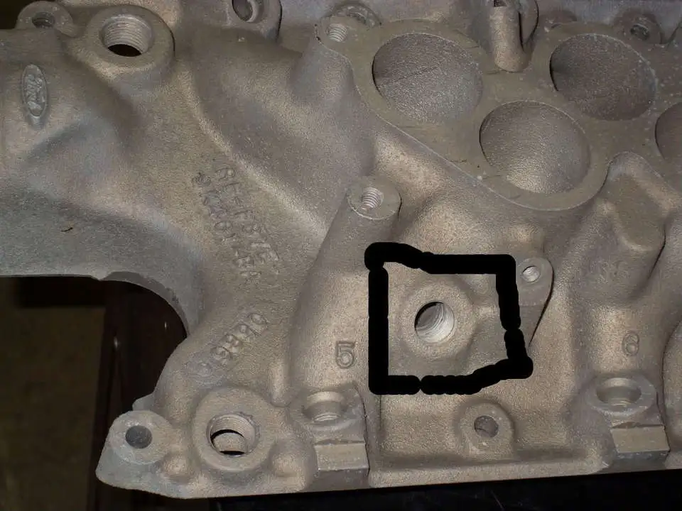

Also, keep in mind you will have to drill and tap the #5 runner in the Explorer lower intake to retrofit your stock manifolds ACT sensor. Not a big job, but necessary if you want to instal the sensor in the factory location.
Reactions: ratio411
