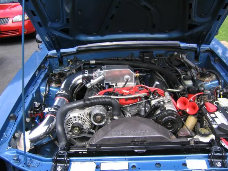

just my 2. ive got a 393 stroker..it drives the same as it did with the stock 302. heavier? yes, more expensive to build? yes, under the stock hood? yes. power and torque.....wait for it.....PRICELESS..............!
