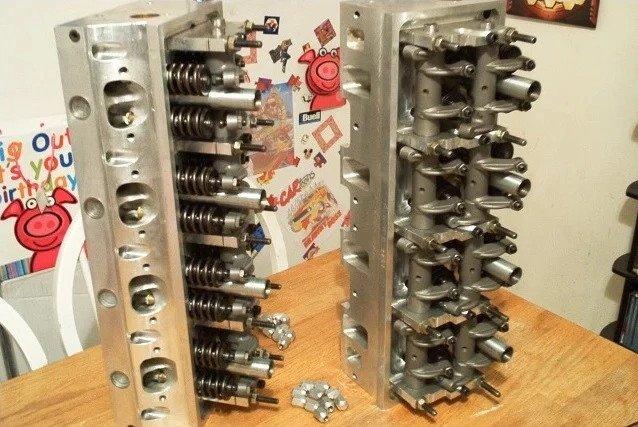

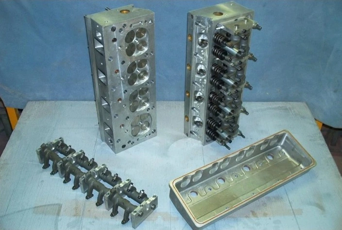

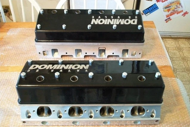

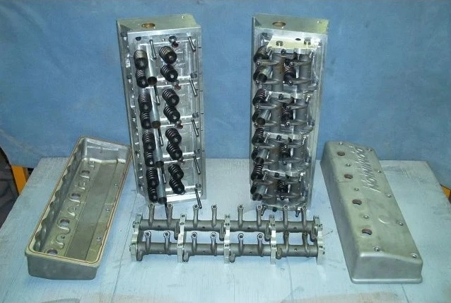

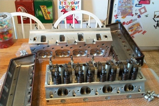

Back in the late 90s, dominion performance released some cnc aluninum 4 valve heads for small block fords that flowed awesome numbers (348 at .650) that retained the stock shortblock without mods. Did the company go out of business, or is anyone still making these heads? Anyone have em?
wow. Thats awesome. If i wouldve known about those, i wouldnt went with those. Any reason why this hasnt been discussed ever. Those look like that would look badass in the engine compartment as well
I'm not sure about you…but I'm not to keen about dishing out 10k for a set of heads! Add to the fact that the last guy that attempted to buy those waited something like 5 years and never received anything…including is high dollar deposit back.
oh. hell with that. I was assuming they were around 3 grand because on the website it says "for the cost of a blower why not run these". :notnice:

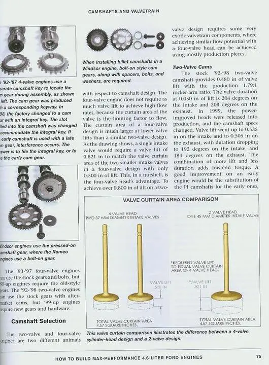

"Curtain area" is really where all the 4 valve heads can out flow 2 valve heads.
