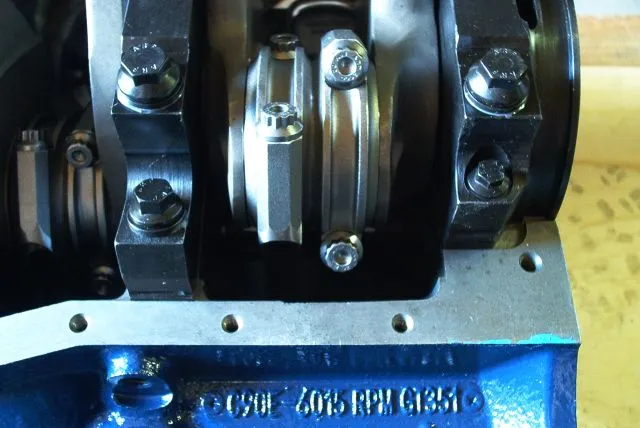

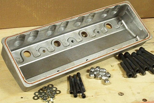

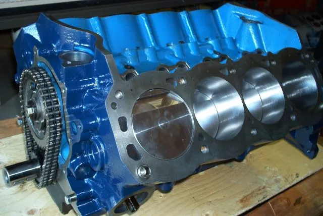

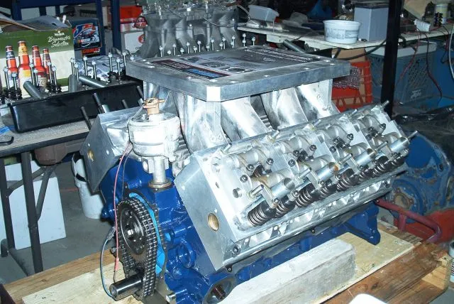

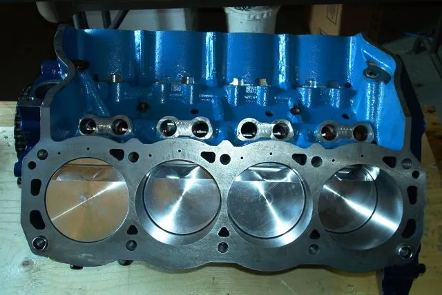

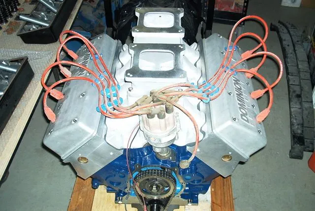

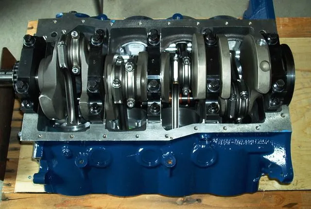

Hi, just thought I would post an update here also. I gave up waiting for the past 3-1/2 years for theses new cleveland blocks to come out for these heads and asked for my deposits back. I now went and bought a complete 428MAXX short block from FPS for these heads now instead. I got FPS help with this project as I found out FPS have already built some of these 32V sbf valve headed engines. So it made it easy to get the custom 4 valve pistons and 4 valve cam cut by FPS. So I am now building a CLEVOR.
I also have learned about all the bs that this billetracing guy did spaming on a bunch of auto forums all over the net inc this one with the same post about being ripped off by arao that turned out to be Bull Crap. I have been trying to contact this guy since mid 2009 with NO luck but anyway there was something not right with this guy with the way he was going about things.
anyway some update pics of what I am doing now...
32V 428MAXX

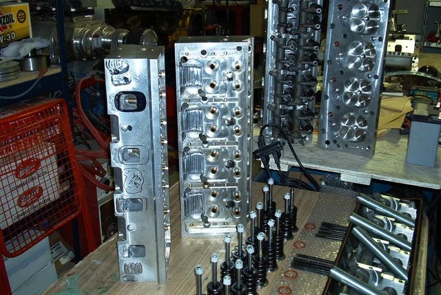

Yes its mine, I just got the short block assembly recently after I gave up waiting on the new cleveland blocks that I wanted to use for these heads, I am still waiting for other parts for it. I have 2 sets and am modding both to boss intake ports for big ci. trying to have it finished buy fall.
32 valve sbf heads

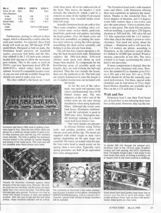

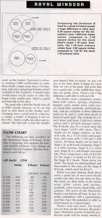

For those interested in this 4 valve tech here are a few old tech articals...
And one more...

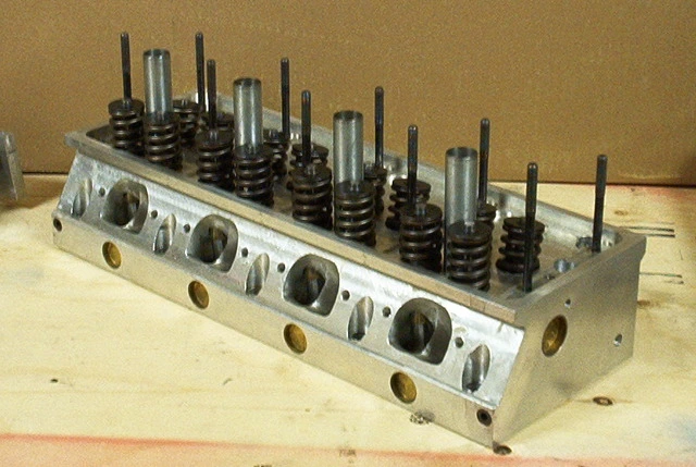

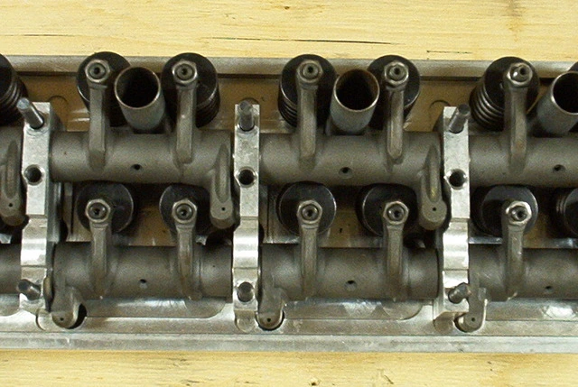

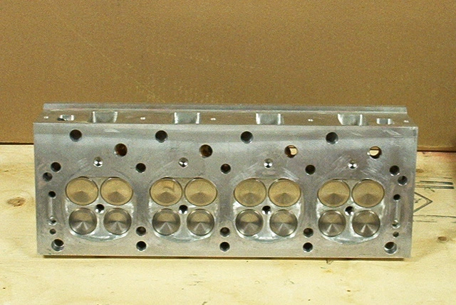

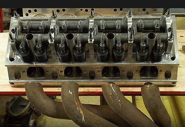

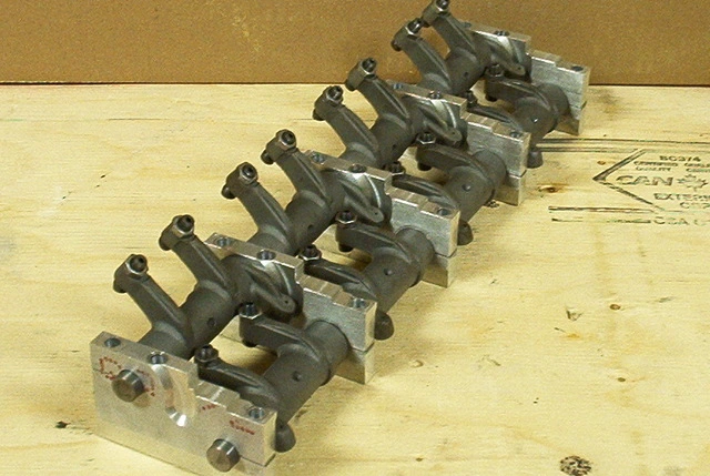

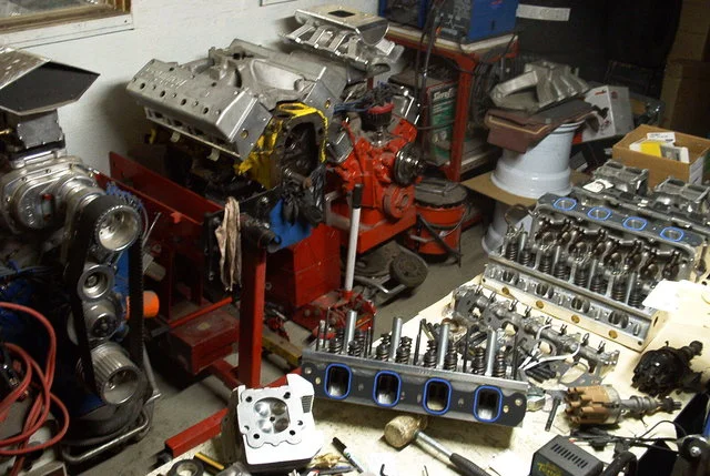

For those that maybe interested here is a few more detailed pics of my other set of 32V heads that have a bigger chamber for a blower/turbo app, I am going to also finish converting these to boss intake ports so I can use any of the 4V cleveland intakes.
