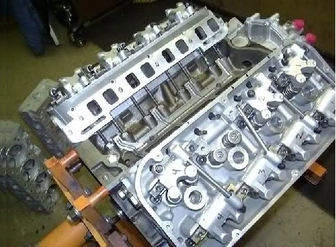

Hi, 4 valve forked rocker pushrod setups have been around since 1915? on old race bikes and even newer bikes so they are proven to work, the spring pressures are not any more than most 2 valve perf setups and only use avg 100 pounds of seat pressure per int valve, this x2 = 200 pounds avg. Most solid rollers use more than this. These heads are modeled on/after the old Weslake 32 valve heads except they can use standard type intakes and can fit in most engine bays. Hal died earlyer last year so these Dominion performance inc versions are not available anymore now. Here is a link to the old Weslake 32 valve versions for comparison...

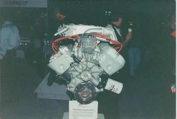

That intake is a newer Ford casting from the early 90"s when Ford had thoughts of offering a 32 valve sbf kit through svo with new efi intake & new rock design...

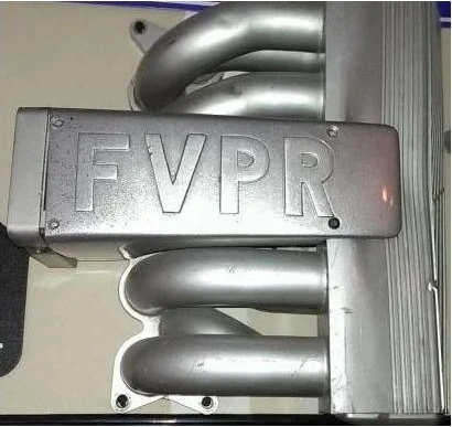

Here is a link with some info/pics on the Original Ford Windsor FVPR setup ...

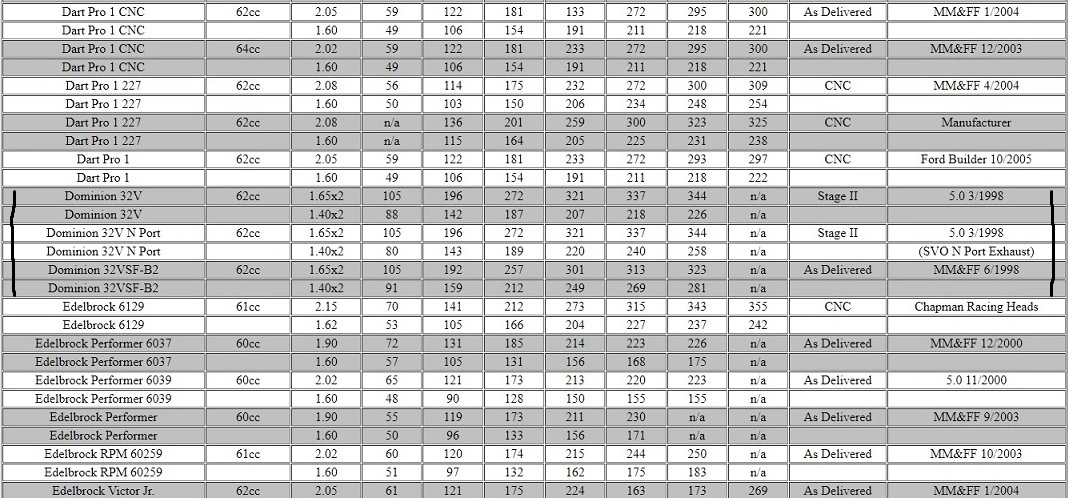

Back in the late 90s, dominion performance released some cnc aluninum 4 valve heads for small block fords that flowed awesome numbers (348 at .650) that retained the stock shortblock without mods. Did the company go out of business, or is anyone still making these heads? Anyone have em?
