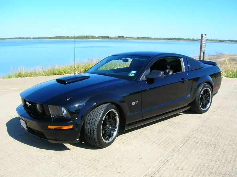

Ive got 18x 9's all the way around and run 255/45/18's. Thats what Late Model Restoration
puts on thier wheel tire combos. Doesnt look streached to me, seems like a perfect fit.
You could go fatter if you wanted, if you like a bit more sidewall bulge.

They actually look a little stretched to me in that pick? I can see from here the rim protruding out past the sidewall of the tire.
Can you take a straight edge, lay it across the entire diameter of the tire and make contact with, or come awfully close to the rim? If so, that's a little too stretched for my taste. It's function able, sure....but again...you've got zero protection when it comes to curb rash...and it does make the ride a lot harsher.
And LMR sells that tire with their packages because they get a bulk discount on that size and because there's less chance of the narrower tire having interference issues, not because it's the best suited size for the wheel.
Look at it thise way....the '03-'04 Cobra's ran 9" wheels all the way around and ran 275mm tires. Those fit perfectly. No stretch, no excessive sidewall bulge and no deterioration in ride quiality or handling. Fitting perfectly square isn't enough. You should have more tire, than rim sticking out.

The tire actually sticks out about a half inch more than the rim. Just enough to not expose the rim to curb damage.
