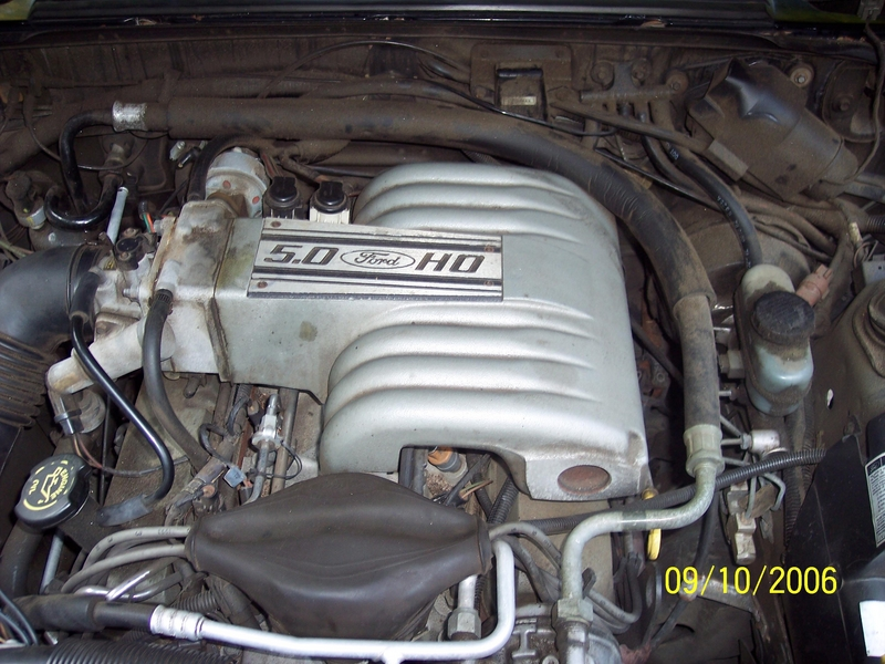

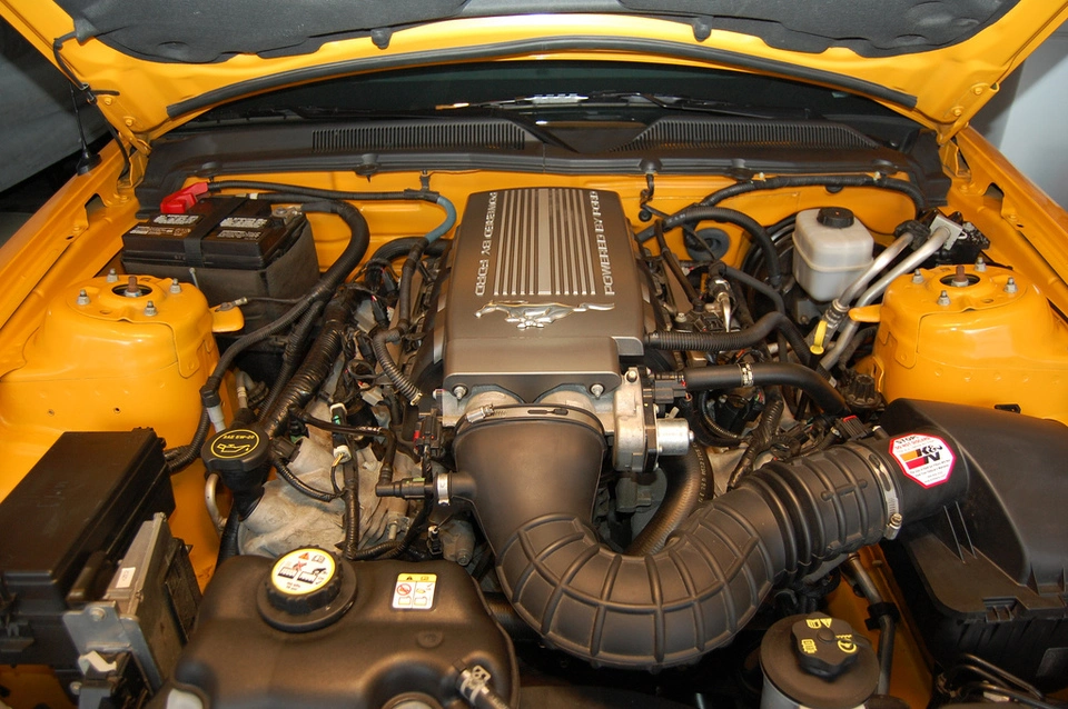

the 5.0 and the 4.6 share nothing but the fact that they both have 8 cylinders.
if it is a non-HO 5.0 that sucks, they had different heads, crappy cam, crappy intake and a different firing order
Yeah, if I'm correct the H.O. and non-HO have completely different cranks in them, giving them the H.O. and different firing order.

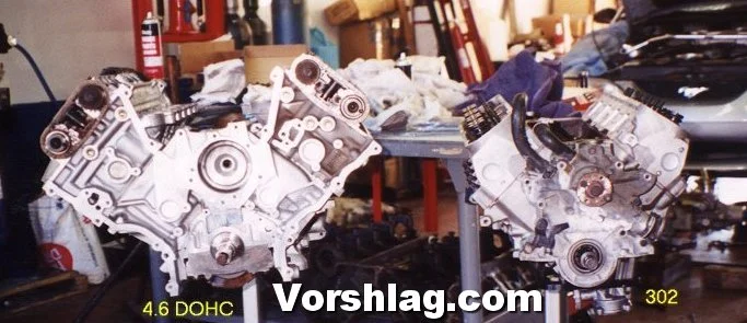

Quick91LX is right. The 4.6 modular and 5.0 pushrod have nothing in common. No parts will switch over, the trannys aren't even swappable.
If I remember correctly the H.O. intake pulled air in from the passenger side of the car and the non-HO pulled in from the drivers side. Basically the intake was reversed.
pushrod (79-95) H.O. 5.0 :
modular 4.6 w/ intake cover (pulls air in from front of engine):
4.6 vs. 5.0 (4.6 is obviously much bigger)
